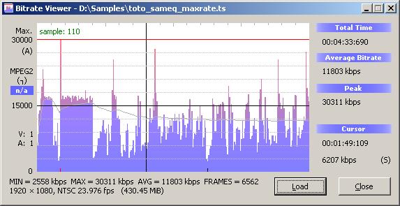

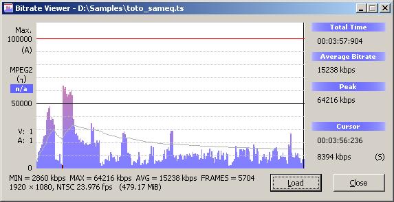

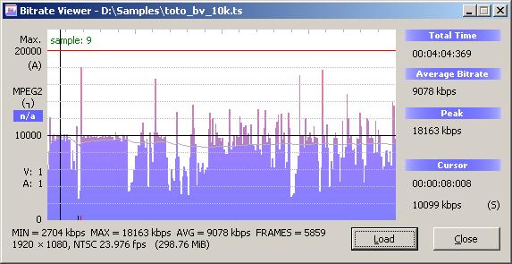

Post Tue Apr 24, 2012 8:54 am
Re: -sameq Change from v0.6.0.1 to v0.6.1
zip wrote:I think you're right. It looks like -b and -qscale/-sameq are mutually exclusive - I'll remove the -sameq parameter for the next patch version.
Not sure it was a good idea to remove -qscale/-sameq option, in fact when maxVBitrate is used on profile, ffmpeg command line used "-b:v", "maxrate=" and "bufsize=" options.
But for example, if you set maxVBitrate=10000, -b:v 10000k -maxrate=10000k, it seems that become a "Constant Video Bitrate" at 10Mbps stream not a "Clipped Video Bitrate" !!
Original file
I try with BigBuckBunny-DivXPlusHD.mkv sample file, with bitrateviewer => average 6Mbps with 21Mbps peak
Transcoded in mpeg2video :
with -sameq only => average 15Mbps with 64Mbps peak !!! not supported by devices
with -b:v 10000k -maxrate 10000k -bufsize 10000k => average 9Mbps with 18Mbps peak , looks like a constant bitrate video stream
with -sameq -b:v 17000k -maxrate 17000k -bufsize 17000k => average 11Mbps with 30Mbps peak, looks like a clipped bitrate video stream but still have high peak birate
Don't know what is the solution...
