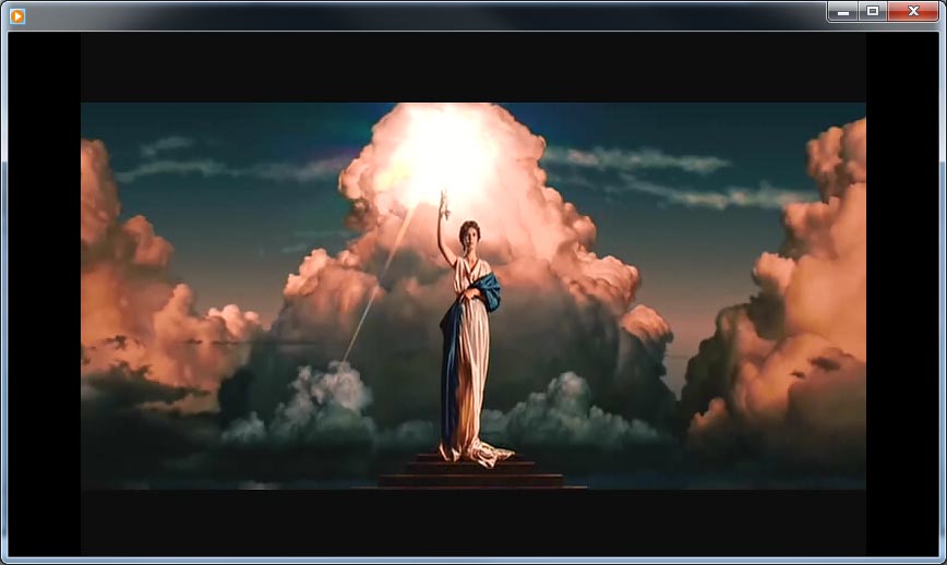

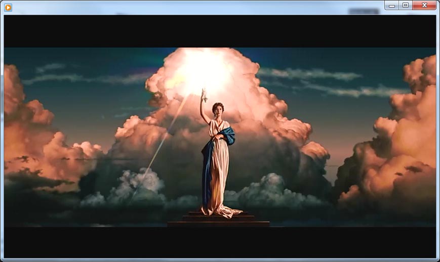

A couple of screen shots. I ran the ffmpeg command the serviio runs and captured the output of both the original and converted files.
Converted
Original
