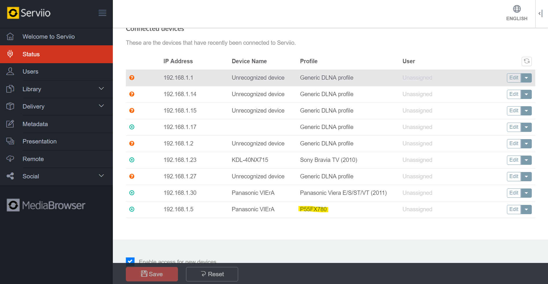

OK, I made the profile active and assigned it to the TV directly via Serviio Console. There seems nothing to be transcoded, audio does not work (error message from TV: audio format is not supported), but Video works.

Re: Profile for Panasonic 55FX780 Series
OK, I see in the log that your TV is still using the Panasonic VIErA profile, not the modified profile. The video is being sent without transcoding, and since the audio is DTS-MA, the TV can't play the sound.
Either that, or you didn't use the same name as my example for your custom profile. Could you post exactly what you entered into the user-profiles.xml file, so I can see what it's trying to do?
Nevermind, I see you did post your profile above. But you haven't selected it as the active profile for your TV in the Serviio console. That's why it's not trying to use the new profile.
Yes I didn't use the same name for the profile, but it shouldn't be a problem and I have selected it as the active profile for the TV.
There is one line in the log that says the profile is active. The Name "Panasonic VIErA" comes from the TV itself. I have another Panasonic TV with the same name.
