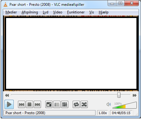

2. Have tested the file with VLC player and finds no defects at given time. "Don't know any other way to test the file, for this type of defect"

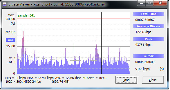

Could you check video bitrate at 4:48 with this tool?

I have tried the tool and I have noticed this.
1. High peak in the beginning doesn't raise any problems.
2. Can't match the exact time - the tool claims video length is 7:34... but TV and VLC says 5:15??
3. If the timeline on VLC is correct, it looks like no peaks around error time, at least not as big as the one in the beginning.
4. I have tested another file that also fails, but this files never cros the 15000 kbps at the point of failure.
