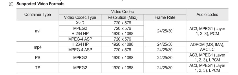

what could be the problem and how to solve it?
Posts: 5537
Post Sat Sep 12, 2015 12:24 am
Re: Transcoding problem with Samsung TV
What model Samsung, and could you provide the media info for one of your files?
tuareg64ve
Posts: 54
Joined: Wed Mar 28, 2012 4:38 am
Post Sat Sep 12, 2015 5:33 am
Samsung model is: SAMSUNG UE28F4000AW
The following is a reference to supported format:
samsung SAMSUNG UE28F4000AW formats
From where Serviio runs, I can play the file with both ffplay and vlc without any problem.

1. Yes you could write a plugin to present all the videos on the web page using the data in the manifest files as .mp4 streams .
2. The Samsung B profile 2 says to transcode these .mp4 streams to mpeg (mpeg-ps). Your zip file is corrupt so I cannot see the command it generated but if it failed try transcoding to mpegts (mpeg-ts)
3. What was the result of using my previous recommendations on the original stream? (Try transcoding them to mpegts as well.
