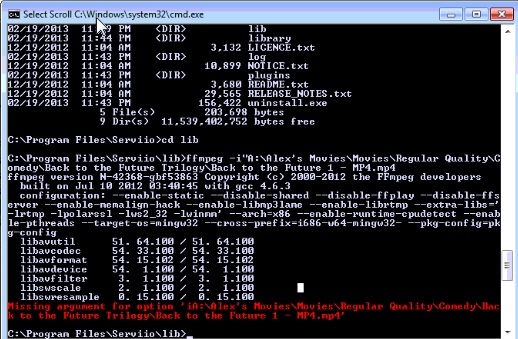

but i did the ffmpeg you suggested and the results are attached, whats keeping it from playing.

I think I know what the issue is with your files, but need to confirm. Can you do a ffmpeg -i again (you missed a space between the -i and the file name in the one above) and also do a MediaInfo if you can on the file.
