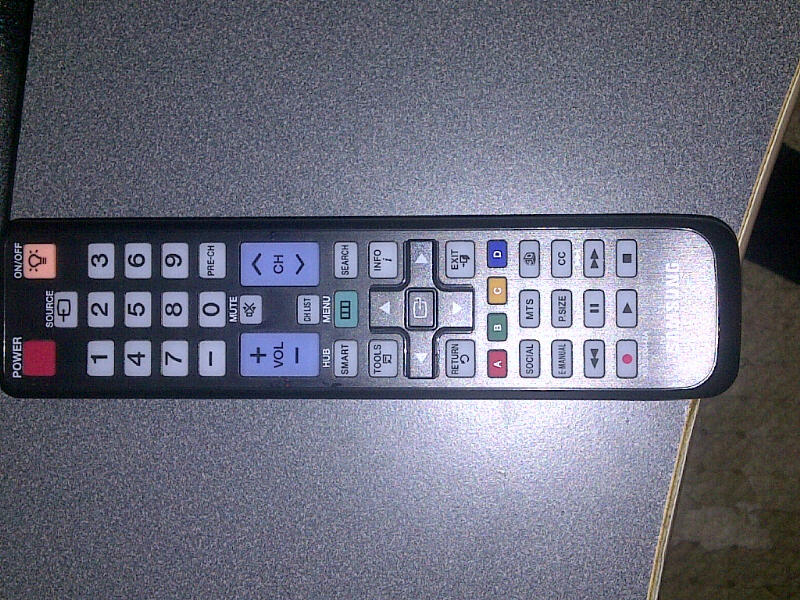

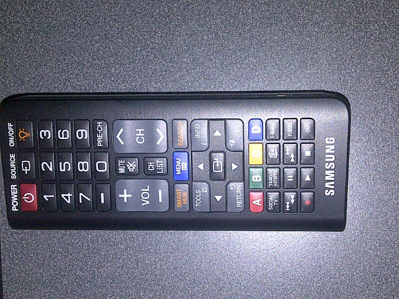

Not seeing that option on either of my remotes. I have the Samsung un55d6400 model.
see attached.
IMG-20120123-00431 (1).jpg (174.32 KiB) Viewed 20320 times
IMG-20120123-00432 (1).jpg (145.46 KiB) Viewed 20320 times

From your manual. Keep hiting source button until serviio or allshare shows up on your screen as the source.
Changing the Input Source
Source
Use to select TV or an external input source
such as a DVD player / Blu-ray player / cable
box / STB satellite receiver.
1. Press the SOURCE button on your
remote.
2. Select a desired external input source.
You can change the view mode among
the All and Connected by pressing the l
or r button.
■■ TV / PC / AV1 / AV2 / COMPONENT /
HDMI1/DVI / HDMI2 / HDMI3 / HDMI4 / USB /
AllShare
✎✎You can only choose external devices that are
connected to the TV. In Source, connected inputs are
highlighted.
✎✎In Source, PC always stays activated
