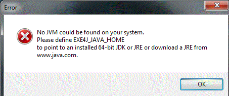

1) Leave Serviio alone (installed and broken)
2) Uninstall both Java versions in Control Panel>Programs & Features (32 bit and 64 bit)
3) Download the latest Java 7 Update 7 versions from java.com (both 32 & 64 bit)
4) Install in this exact order 64 bit Java, then 32 bit Java
5) From Start Menu launch "Start Serviio Service" then "Serviio Console"
6) Right click tray icon when it appears (after hard drive thrashing is done) and "Force Library Refresh" NOTE: This may take forever since you uninstalled the program
You may have noticed the Serviio error as per my attachment
Serviio error (even though Java is installed!)
