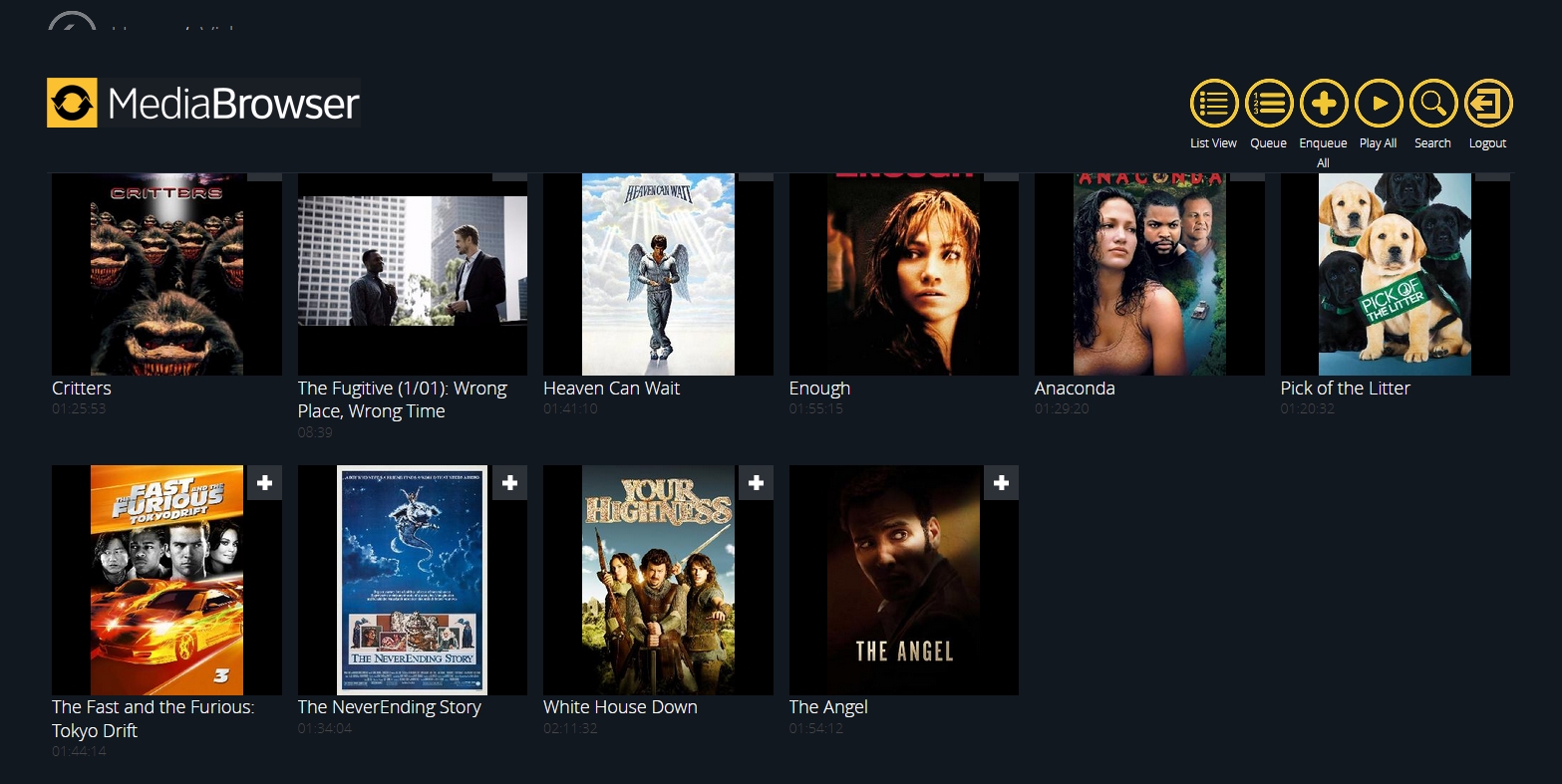

Screenshot_2020-08-21 MediaBrowser.jpg (400.72 KiB) Viewed 4659 times
Are the nfo files present in the same folder as the movies? It works for me I have it set to xbmc nfo files and it reads them:
Here if you notice White House Down is showing the wrong poster, because there is no appropriate named jpg file with it.
Each movie needs an nfo and jpg of the same name for metadata to work in nfo mode.
