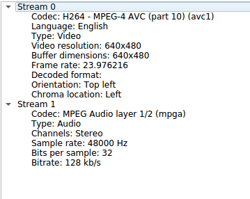

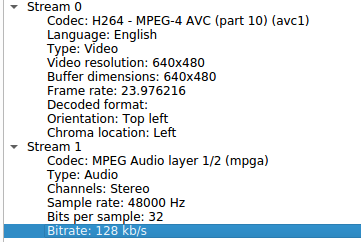

here's a strange one to me...
this file plays (just a shot from VLC tools/media/codec)
this one dont..
I can't tell any difference...

I've never come across mpga audio before. Usually most video files contain DD, DTS or AAC audio. I know there's no Matches line for that audio codec, but it is an available option. It's very strange that one will play and another won't, since they appear identical.

This is from the file I posted earlier that wouldn't play..
Stream #0:0(eng): Video: h264 (High), yuv420p(progressive), 640x480 [SAR 4:3 DAR 16:9], 23.98 fps, 23.98 tbr, 1k tbn, 47.95 tbc (default)
Stream #0:1: Audio: mp3, 48000 Hz, stereo, fltp, 128 kb/s (default)

seems the method I used to grab audio info earlier wasn't so accurate (VLC)
