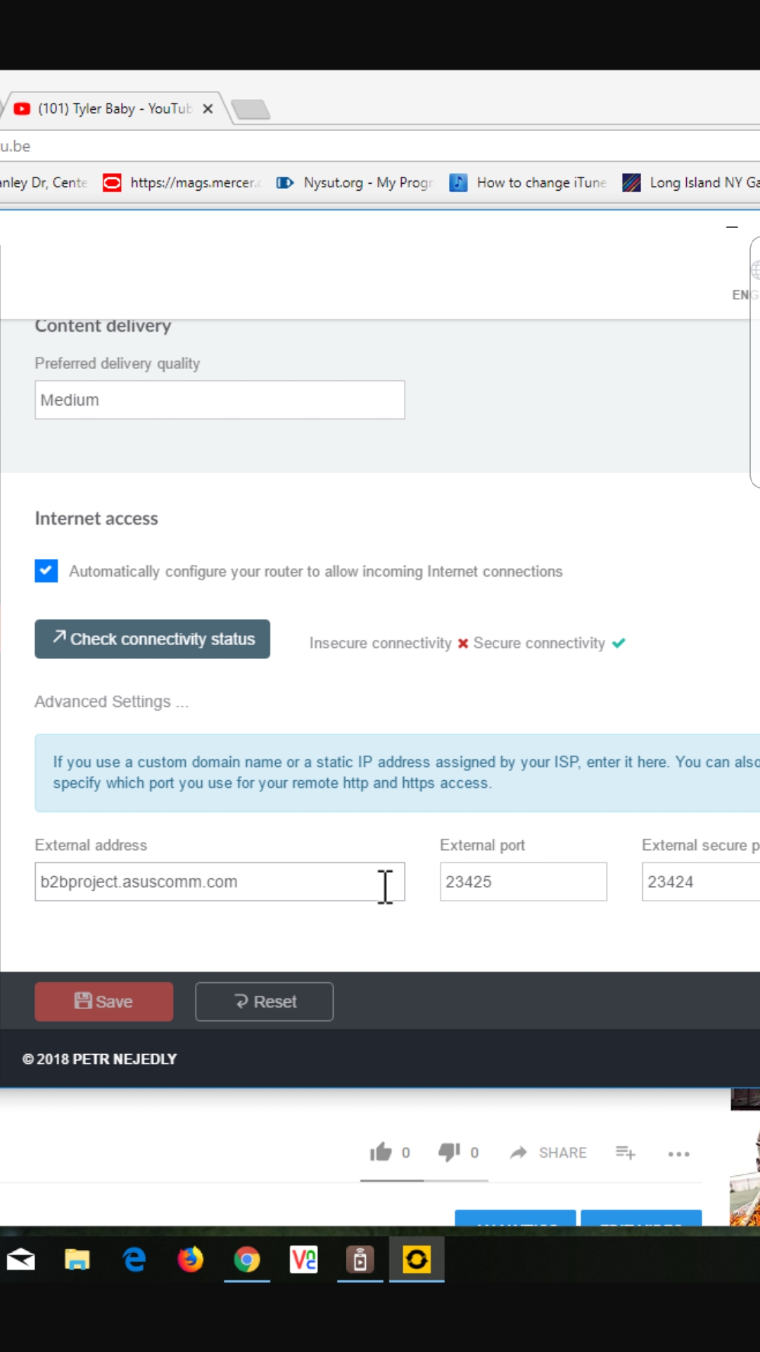

Yes. Remote access works. I have a secure check, and entered my ddns for the domain..... remote access works from my serviigo app...
Maybe I should try removing my ddns?
Tried it and didnt help....
I even tried matching ports exactly like in your link..

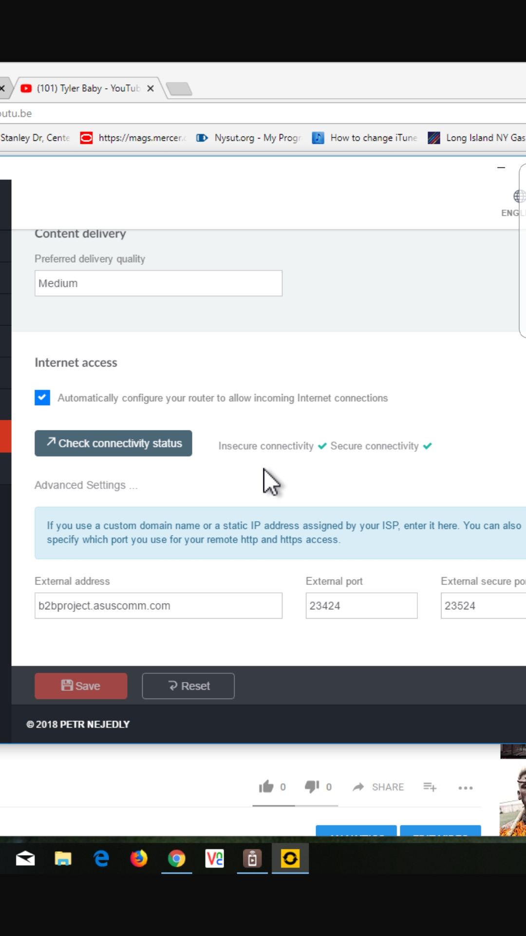

Screenshot_20180909-231335_VNC Viewer.jpg (301.95 KiB) Viewed 26410 times
Screenshot_20180909-225638_VNC Viewer.jpg (299.83 KiB) Viewed 26410 times

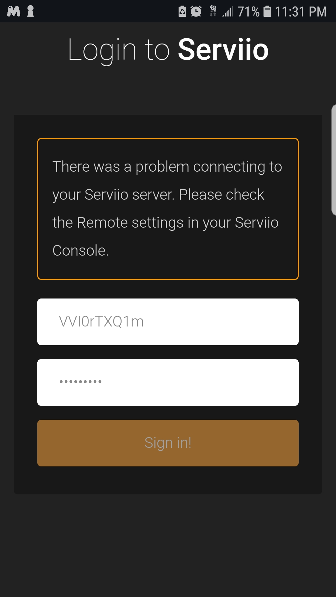

I tried changing the remote password, and I get this error only on the first try....
Screenshot_20180909-233107_Samsung Internet.jpg (149.52 KiB) Viewed 26410 times

I can still see your server identifying itself as http 23425 and https 23424.
You should have http 23424 (external port) and https 23524 (External secure port) - change the ports to these values in your Serviio console and Save. You should then get both checks in the console green. Then try to use the skill again.

jared69sib wrote:
zip wrote:I can still see your server identifying itself as http 23425 and https 23424.
I actually had extra ports open in the same range existing from an older server running a separate serviio server that I am not even using anymore...I think that might have been causing some confusion... I don't know.. I tried what you said above, and I'm only getting one check for secure 23424, not http 23425... I will remove all extra port forwarding now that might be causing confusion during you scans...
Ok. Somehow that helped. I guess it was either my router or how you're scanning ports... I changed the secure port back to 23524 and got check marks on both. It actually linked. Thanks for your help.
