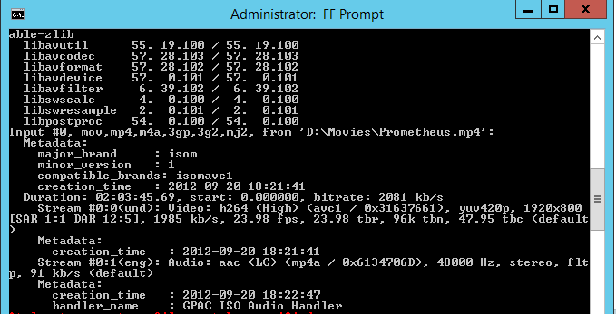

It's transcoded, using h264. So I'm not sure why it's transacoded (didn't check the profile, might be due to high level) and also your CPU might not be srong enough for transcoding to h264 in real-time.
Try to disable transcoding in the console and play the file again.

I was unsure which Roku model is the 2720X, so I looked it up. Yours is newer than mine, although still called a Roku 2. The Roku will play MP4 and MKV H.264 without transcoding, but as Zip mentioned it might be above L4.1. However, based on the limited view of your media information, it doesn't look like it. My 2 XS will support up to about a 12 kbps stream, and it looks like that file is well below that. Yours should do that or better. It also supports AAC audio, so there should be no reason for the file to be transcoded. That of course is slowing down your load time, but my earlier comment about the RMP buffering an excessive amount still applies.
Not sure why transcoding is being triggered, unless perhaps you have burned in captions enabled on the Serviio console. Do as Zip suggests and disable transcoding and try again.

Thank you! That did it!
My load time went down to about 8 seconds and the videos FF, RW, Play with no issues now.
