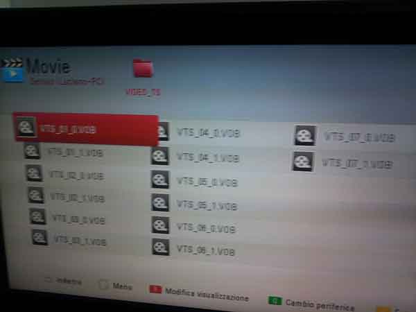

Hi, I bought Serviio pro and version 1.6 installed. through the reader I read the library but I have problems with the dvd structure. the previous version I saw entire hotel now with version 1.6 I see only the first two of each group vob, for example see vts_01_0.vob, vts_01_1.vob, vts_02_0.vob, vts_02_1.vobb etc ... I can not see where the part containing the title track, for example vts_01_3 etc. How can I do?

Re: dvd structure
yes sure, stacking is enabled but I see two files for each vob as explained above

Re: dvd structure
I attach as required directory listing that you see from my lg bp620, compared to a player dlna seen on my phone do not see the file properties

-rw-rw-rw- 1 glz glz 307k Feb 27 17:41 Throne of Blood.jpg
-rw-rw-rw- 1 glz glz 6.7k Feb 27 17:41 Throne of Blood.nfo
-rw-rw-rw- 1 glz glz 307k Feb 27 17:41 Throne of Blood.tbn
-rw-rw-rw- 1 glz glz 911k Feb 27 17:41 backdrop.jpg
-rw-rw-rw- 1 glz glz 971k Feb 27 17:41 backdrop1.jpg
-rw-rw-rw- 1 glz glz 854k Feb 27 17:41 backdrop2.jpg
-rw-rw-rw- 1 glz glz 307k Feb 27 17:41 folder.jpg
-rw-rw-rw- 1 glz glz 12k Feb 27 17:41 movie.xml
-r-xr-xr-x 1 glz glz 1G Feb 26 11:58 vts_01_1.vob*
-r-xr-xr-x 1 glz glz 1G Feb 26 11:59 vts_01_2.vob*
-r-xr-xr-x 1 glz glz 1G Feb 26 11:59 vts_01_3.vob*
-r-xr-xr-x 1 glz glz 867M Feb 26 11:59 vts_01_4.vob*
but not this, which also shows up as two entries, pt1 and pt2, in the /Home/Video/Movies path:

I see no structural difference to why Yojimbo is seen as a stack and Stalker is not. Only difference is that Stalker was added in Servo 1.5.
Any ideas?
Re: dvd structure
Works for me with your naming. Can you post ffmpeg -i for both parts of Stalker?

Re: dvd structure
Right, so it won't match them as they have different resolutions.
Petr
Help translate Serviio
Re: dvd structure
Ahh. Will make new copies.
