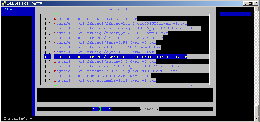

The log file is showing unknown file type. Have you installed ffmpeg? If so where? The recommend ffmpeg for ffp on Zyxel NSA is "slacker -Uai br2:ffmpeg". You might need to edit the value "-Dffmpeg.location=" in your serviio.sh script to point to it.

Yes, I could see the unknown file type message in the log file. That was a kind of a surprise to me, because I've installed ffmpeg before on the old NSA version. Actually I used the procedure from here: viewtopic.php?f=14&t=13449
These two packages were working:
install mz:lame-3.99.5-arm-1.txz
install uli:ffmpeg-1.2.1-arm-1.txz
There was nothing in the instruction of pointing the "-Dffmpeg.location=" in the serviio.sh script. I can't see a certain line for that in the file.
In the attachment you can find all available ffmpeg packages under slacker for -Uai br2. I made a search to install the one you pointed as the ffmpeg for ffp on Zyxel NSA, but I wasn't sure if ffmpeg-2.1.8_git20150612-arm-1 is the correct one.
At the end, I've just updated (reinstalled) the package from the first installation - install uli:ffmpeg-1.2.1-arm-1.txz
Fortunately it has started working :P I'm not sure why it was required, but it seems like ffmpeg was lost.
