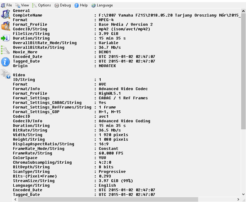

Media info
mediainfo git2 gitup 1080p 60fps .jpg (134.64 KiB) Viewed 8819 times

What profile is assigned to your TV? My guess is the profile isn't calling for transcoding, but your video has H.264 L5.1 video, and I think your TV only supports L4.1 or lower. Can't say for certain, but my guess. You could try a different profile, such as the DirecTV profile, which transcodes everything.

For the techo's: Even though the file is being tagged as a High 5.1 Level in the metadata/header that is contrary to what the file attributes are telling us (if I do the maths on the file attributes the file is only a High 3.0 Level) - see http://wiki.serviio.org/doku.php?id=get_h264_level. As the file attributes are 3.0 the transcode statement <Matches container="*" vCodec="h264" profile="high" levelGreaterThan="4.2" /> is not being triggered when it probably needs to be. Setting the H264LevelCheck to ANY will use either the header info or the file attributes, whichever is higher --> the transcode statement should now get triggered.
