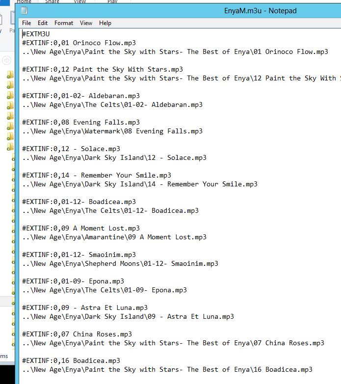

Attached is an example of a m3u that works in an environment that includes a Nas. A snippet of a playlist I use for background noise with approximately 200 titles. Note the ".." as opposed to a UNC or Mapped drive such as "m:\ or \\saw\music". Create a folder called playlist in the tree where the audio files are stored. Use your playlist creating software and save the .wpl .m3u or what ever to a work folder not included in the serviio library. Open the created file and edit it if needed (see below). Then copy the playlist file to the folder created in the serviio library path.
Edit if Necessary...........
if you are using Windows media player the to create the list it more than likely will create a playlist with local paths. Won't work across shared devices. The .. in a m3u just tells it to append the path to the beginning of the string. As long as the playlist file exists in the same folder tree the path will be correct.
May seem long handed but I have created playlists this way that include 4-500 titles that I use for exactly the purpose you describe. As for Restarting the service I know for a fact that the poller will do a fresh search on each restart. I just do it out of habit and it hasn't failed me.
Additionally, If the poller cannot validate any items in the playlist it will not show in the media browser. So, if the path used in the playlist cannot be resolved the playlist won't appear in the media browser even if it shows as added in the log.

I opened the .m3u in Word, chose to find and replace "\\DS413\Audio" with ".." and then saved the changed data to a new .m3u file.
Serviio found then added the new playlist and it seems to be working. Looks like it was all to do with the paths directing it to \\DS413\ on the LAN.
