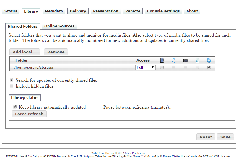

Just installed Serviio 1.5 on Debian Jessie server (no desktop).
FFmpeg installed
Java 8 installed
Also installed php web ui v1.4beta.
The web UI displays as expected in my browser.
I can add a folder to the library. But when I press "save", the added folder disappears and no content (from the folder) is added.
How can I trouble shoot this?
Thanks!
/Erik

is there something in the server serviio.log? It looks like the webui version is either old or has not fully implemented all the 1.5 API changes

Yes. Looks like incompatible version. You could try the latest webui version from viewtopic.php?f=17&t=12593
Otherwise, if you have Android device, give ServiiDroid a try

Updating the PHP Web UI made it a bit more "robust" but the upload still didn't work. The log reviled this error message:
2015-01-20 18:36:08,253 WARN  [ServiioStatusService] UnknownFieldException occured. Returning error code 500 to the REST layer. Message: No such field org.serviio.ui.representation.SharedFolder.scanForUpdates
---- Debugging information ----
field               : scanForUpdates
class               : org.serviio.ui.representation.SharedFolder
required-type       : org.serviio.ui.representation.SharedFolder
converter-type      : com.thoughtworks.xstream.converters.reflection.ReflectionConverter
path                : /repository/sharedFolders/sharedFolder/scanForUpdates
class[1]            : java.util.ArrayList
converter-type[1]   : com.thoughtworks.xstream.converters.collections.CollectionConverter
class[2]            : org.serviio.ui.representation.RepositoryRepresentation
version             : 1.4.7
But I installed the android app and it worked wonderfully. Congratulations on a great app. I bought the donation key immediately. :D

yes - you need the version that is compatible for 1.5. It will appear on the wiki, once it's available:
http://wiki.serviio.org/doku.php?id=phpwebui
