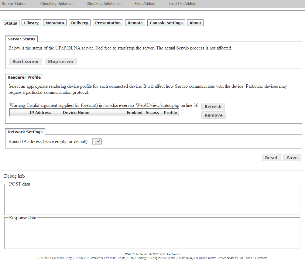

I've also attached a screenshot of the WebUI (WebUI v1.4beta),
but I'm sure it's not working because the serviio service isn't running. I understand there is a seperate thread for this, so if the UI isn't working after the service is sorted, I will open the issue up there.
