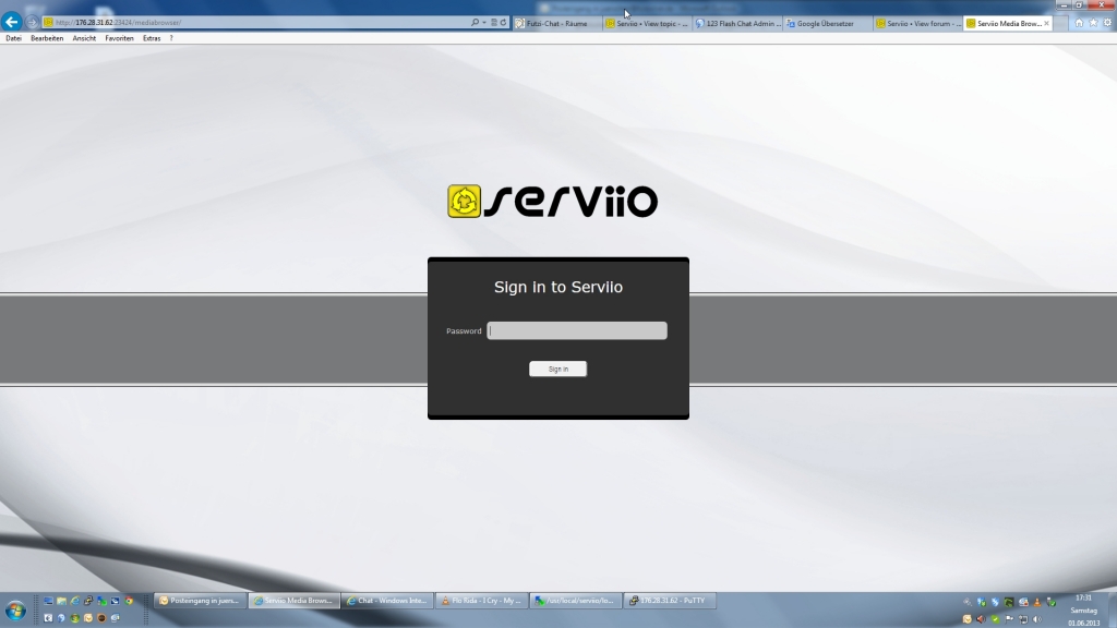

my system: debian 6.0 64 bit, when I start the server, I get the following message:
2013-06-01 10:02:05,897 WARN [FFMPEGWrapper] FFmpeg is not compiled with librtmp support, RTMP streaming will not work.
2013-06-01 10:02:05,897 WARN [FFMPEGWrapper] FFmpeg is not compiled with libass support, rendering subtitles (hardsub) will not work.
how can I compile librtm and libass support?
when I run the web server, I just get a registration page with password query. but I would like to activate the license. or where I can copy the pc5dczc_xxxxxxx.lic , so I have the pro version?
http://176.28.31.62:23424/mediabrowser/

if you're still running the 15 days evaluation version of Pro, just enter the password in the console (remote tab) and use it in the MediaBrowser.
Re FFmpeg, there is a wiki article on how to compile in on Linux.

i have no remote tab. the software is running on a root-server without graphic surfaces, only command line

The MediaBrowser is just for viewing content remotely, you cannot setup the server using it.
You can upload the licence using the comand line viewtopic.php?f=17&t=5330&p=50586&hilit=curl+License#p50586
However, you will need the console to configure the server. So you can install the console on your PC and point it to the server http://www.serviio.org/component/conten ... e?id=21#q2 or use ServiiDroid (Android), or one of the WP apps, or you can install the PHP Web UI on your server and use that (http://wiki.serviio.org/doku.php?id=phpwebui, requires apache, and curl for apache, install by doing git clone git://github.com/mpemberton5/Web-UI-for-Serviio.git /var/www/serviioweb)
