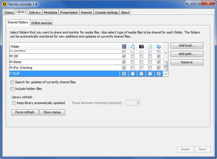

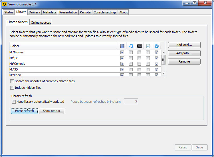

Can you post screenshot of your Library tab in the console?
anniebody
Posts: 79
Post Sun Feb 16, 2014 7:55 pm
Re: Windows 7 x64 No Library Found
See attachments. M drive is the caddy, F drive is a local partition.
Post Mon Feb 17, 2014 10:36 pm
Ok, so I think you have to uncheck the automatic scan for your folders (the circular arrow). The other checkbox means to scan for metadata updates for existing files.
