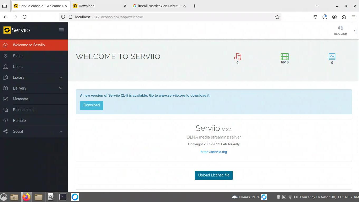

Well I got into the browser OK and the console came up OK, thanks for that I'm on version 2.1, is it worth upgrading ? and how is it done via the command line

I just have to point you to the release notes for you to decide if you want the latest version. Version 2.1 is now over 5 years old, and I'm pretty sure there's some worthwhile improvements in it. https://serviio.org/news
I can't remember exactly how you update Serviio on Linux. If I remember correctly you simply unzip the main file and then copy everything over the existing install. But I can't be sure of that, so check the website for more details.

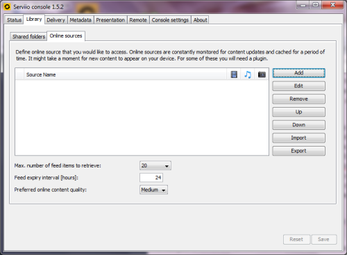

I've been looking for the Serviio GUI for ubuntu as I stated before, I remember using it but had to install java to get it going, I can't seem to find any thing on it other than an image on what it used to looking like
but as you said 5 years that's how long since I've touch this Linux box lol, its all up to date now
Posts: 5445
Post Thu Oct 30, 2025 3:16 pm
Re: Serviio Console
It's been a long, long time since I've used the console app. The web version does everything and I don't need to worry about if it's on a specific computer. :D
