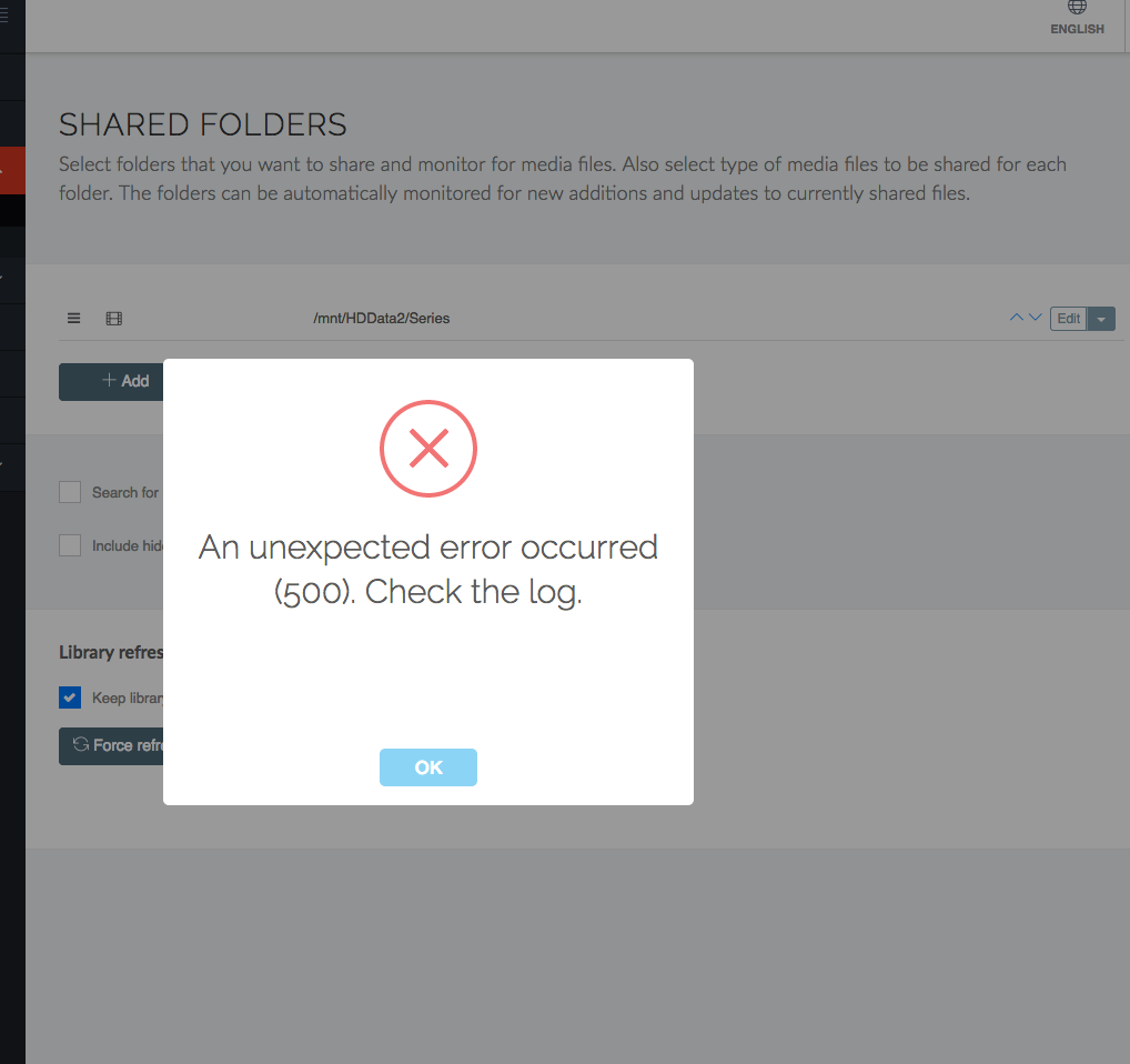

I´m adding folder to serviio and i get server error
Server Error
Captura de pantalla 2017-07-10 a las 13.38.12.png (86.84 KiB) Viewed 17503 times
It´s a fstab mounted disk, but it has 777 permissions.
where is the log file that it says to check.
i try with [serviio folder]/log/* files but, here it isn´t and also with /var/logs/*
some ideas please??
thank you.

But does the Serviio service have 777 permissions? You can't go by your user permissions, unless you change the Serviio service to run under your user account.

Post Wed Jul 12, 2017 12:30 am
Re: Web console Error adding shared folder
I don´t know where was the problems but after many proobes, I knew the ploblem was in permissions.
if i star service manually with sudo command, the console saves folders perfectly but i don´t know which files writes the console service, so i can´t change permission.

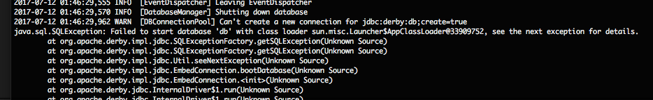

after some changes i saw an error messages in log( klap klap klap), here says something about database cant start or somethin like that
db error
Captura de pantalla 2017-07-12 a las 2.24.02.png (54.58 KiB) Viewed 17476 times
So i thought, the first time that i started the program was with my user manually, it solves many problems, why not start it with serviio user manually and then with service that uses serviio user? and now it works.
if it helps someone, this is my experience.

the user that runs the service needs a write access to the installation folder

i supposed that, so i changed the owner and group of serviio folder and i put 777 permissions( others), but it hadnt worked.
