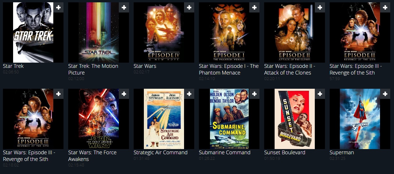

Very strange occurrence. Serviio is identifying the same files differently in the main browser window and a Playlist window. Remember that these are the same files, in the same location. I have all 7 Star Wars videos, all ripped as M2TS files and stored in the same location. In MediaBrowser under the Title/S presentation, they are not listed accurately. Episode 3 is listed twice, episode 5 & 6 are missing (although I'm sure the duplicate 3 is one of them).
Capture SW1.jpg (280.11 KiB) Viewed 8660 times

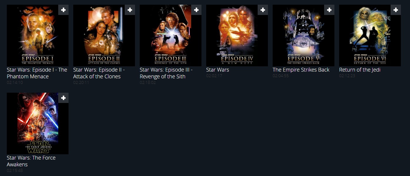

But in the Playlist, all 7 titles are labeled accurately.
Capture SW2.jpg (171.71 KiB) Viewed 8660 times

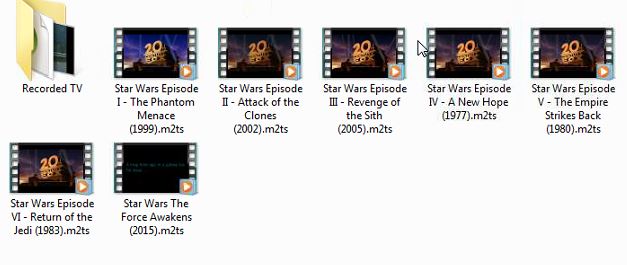

All files are named accurately:
Capture SW3.JPG (36.79 KiB) Viewed 8660 times

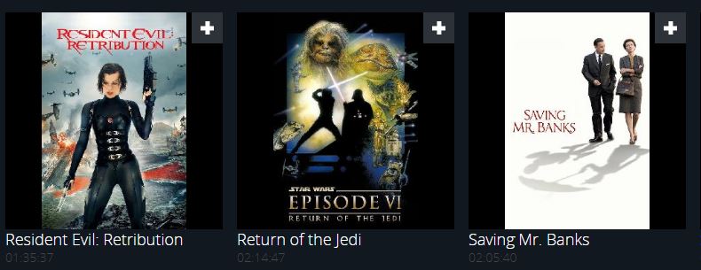

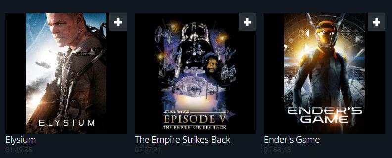

On my setup they appear as:
and
I'm at a loss as to why they wouldn't appear under "E" and "R" in your "Movies" list - their titles are being enumerated correctly (as they are in themoviedb) as evident in your playlist, which is showing their titles as starting with an "E" (ignoring the word "The") and "R".

HA! I just looked at MediaBrowser again on both servers. Yep, they are there under E and R. I swear they weren't there two days ago! Still doesn't explain the duplicate listings under S, but I'll take what I can get... :o

I'd say they are some other files completly. Look at their durations - most match the durations of the files in your Playlist, bu the 2 are not present in the playlist (57:xx minutes - weird, right? Probably an episode of something, or a forgotten .vob file)

zip wrote:I'd say they are some other files completly. Look at their durations - most match the durations of the files in your Playlist, bu the 2 are not present in the playlist (57:xx minutes - weird, right? Probably an episode of something, or a forgotten .vob file)
On the main server, I did find a couple of duplicates. That cleaned it up. On both servers I renamed the 3 episodes to match what themovieDB now assigns to them. No display issues on the main server. On the test server, it still shows two versions of Episode III. One is as you noted only showing 57 minutes in length. When I play it, it plays. But I can't find the silly file on the computer. It must be there somewhere :lol:
I've even checked the Folder view, and the 2nd video isn't shown anywhere. Can't figure out where it is!
