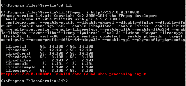

Post result of ffmpeg -i http://127.0.0.1:8080
Neven
Posts: 17
Joined: Sun Sep 04, 2016 12:43 pm
Post Fri Sep 23, 2016 10:17 am
Re: Serviio does not see the PC as online video source
Hi, thank you.
There is one ffmpeg.exe in serviio/lib.
Result when streaming not running
Streaming a mp4 file running
ffmpeg running.png (11.92 KiB) Viewed 12886 times

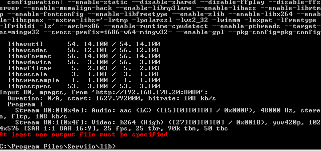

Streaming running, with address of PC 192.168.178.20 instead of 127.0.0.1
ffmpeg running 1 .png (12.53 KiB) Viewed 12885 times
Post Fri Sep 23, 2016 3:10 pm
Ok, so you will have to use the computer IP. Does that work?

Same.
But how it can work when missing a parameter?
The red ffmpeg message saying "at least one output file must be specified"
Or something should be set in VLC, although it works on the host.
Post Mon Sep 26, 2016 6:50 pm
Ignore the red ffmpeg message.
