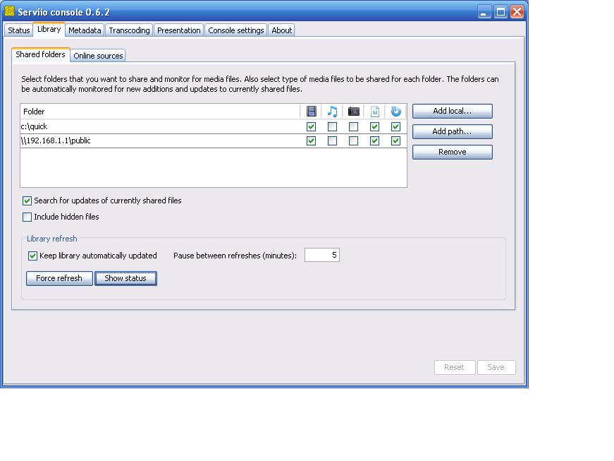

Can you take a screenshot of your serviio console on the library tab and post it here?

I used local for the c: portion and path for network portion.
thank you for taking a look. screen shot attached.

In your first quote you used "\\192.168.1.1\movies " In the Screenshot you used "\\192.168.1.1\public"

the way the e3000 creates the mapping, the root directory has to be named. public is the correct name and then I actually have a movies directory underneath. I have been trying lots of different ways. \\192.168.1.1\public\movies is where the movies reside. I verified this works in both browser and explorer. I have tried serviio with and w/o the "movies" portion.
