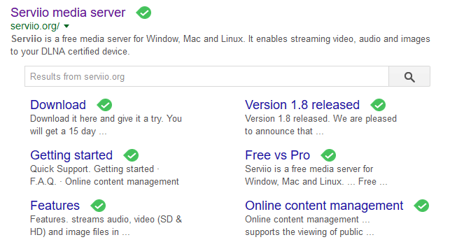

Normally I get the results shown in the attached image and when I click the "Serviio media server" link I would sometimes get the redirect. Over the next few days I will pay more attention and test it out for you guys. For some reason though I seem to recall a link to the Forums in that list. I see in the screenshot it doesn't have it this time. Odd.
