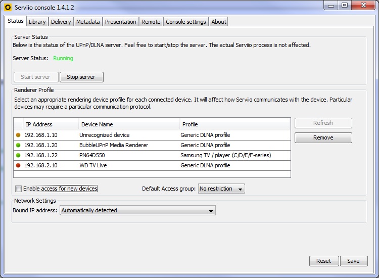

What causes devices to be greyed out on Console/Status?
I have a green light on my Tablet Running Bubble but it is greyed out so cannot access Serviio?
How do I fix this?
If I delete the device from the console, Serviio immediately becomes available on the device, but the device does nor reappear on the console....which makes no sense at all!
Then after a long wait (10+ minutes) it appears on the console. But why was it greyed out, and why did it not reactivate when the green light went on? Looks like a bug to me.
I can then set the profile for the device as per the next post.

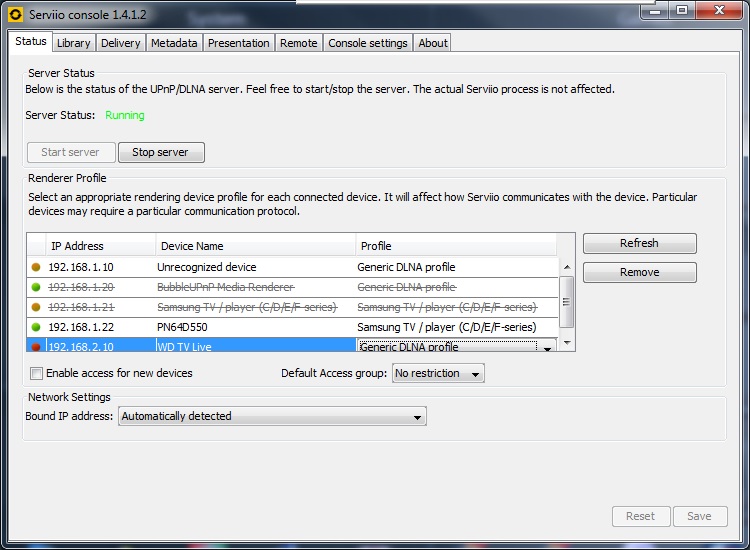

I noticed the same problem with my new Samsung TV, but only on one of my Serviio boxes. Have no idea why it loaded that way, but you can right-click on entry and allow the device to work with Serviio. Hit the save button and the line-out disappears and it is no longer grayed out. Then your device can use Serviio. Worked for me last night.
And I do have Serviio configured to allow all new devices to connect and use. Strange why one Serviio box had no issue, while the other was blocked. :?

I assume you have to select Enable access for new devices. If you means the strike-through entries as greyed out.
Items like that mean the device has no access.
Seems this is the answer, although it is not documented anywhere.
Any device can be disabled/enabled by right clicking and clicking or unclicking "Device Allowed" and then saving.
