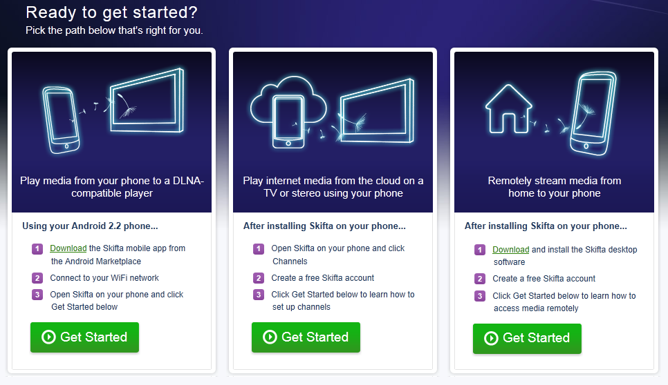

So from a central serviio server you want to browse and play content to a device ? If you ignore browsing via the tv (which would seem the easy option) then have you tried skifta ? Its a browse / push app to any networks you make available and join.

Those pictures don't explain everything Skifta can do, they are just easy basic guides. Anyway, you want to play media from Serviio at work over the internet.

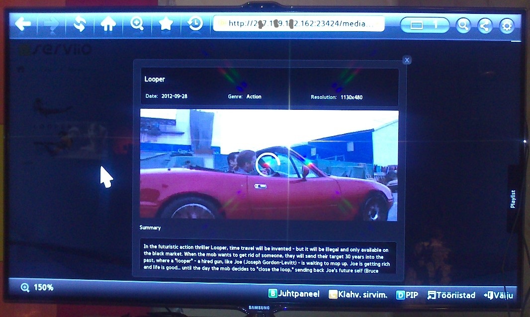

I tryed now to browse serviio mediabrowser over internet from tv. Actually thats working by somehow. But result wasnt not good at all. I dont know whay.
Serviio media browser over internet from tv.jpg (209.71 KiB) Viewed 19172 times
Post Tue Dec 25, 2012 8:28 pm
Re: Smart Hub TV App
Looks ok to me.
NX3
Posts: 578
Post Tue Dec 25, 2012 9:52 pm
Aye looks fine, what were you expecting?
Sent from my HTC Desire S using Tapatalk 2
Meelis
Posts: 127
Location: Estonia
Post Tue Dec 25, 2012 10:35 pm
I was expecting picture like from local network over dlna. There was no fullscreen option. ( maybe i dont know and it is exist) Picture quality was wery bad. And something wrong with connection i think. Movie didnt runn normaly. It was like downloading (buffering maybe) a bit and then played a fiew seconds and then again the same.... For mobile phone that is maybe good enought. But not for tv. :( . I dont think that something wrong with my connection.
I found one article from swedish forum and this is in english. This is it what i am looking for but its not so easy to made it :)
http://www.techsweden.org/forum/viewtop ... 5&t=224879
Post Tue Dec 25, 2012 11:03 pm
There is Fullscreen button, move the mouse over the player.
The speed mostly depends on the source and it's uplink speed. These are normally quite low for home broadband and you might struggle to stream a full quality movies. You can change the quality on the source Serviio's console.

Ok, i found that button and i got the full screen. I tryed it again and its still too slow. Seems its like downloading the movie and then trying to play it :) Then i tryed with the same settings thrue android and that works well. I think its a some tv browser issue or something like that. I dont belive that issue with my internet connection at home. I have here ip tv and everything works well. Server upload is 40 up and i belive that must be enought. At home i have download only 12. I sended link to my friend who have better connection 100 down and hi teld me that movie also like cutting. Not playing smoothly. Hi was thinking that this is a some flash player issue. Also in the right top coner are watermark.
