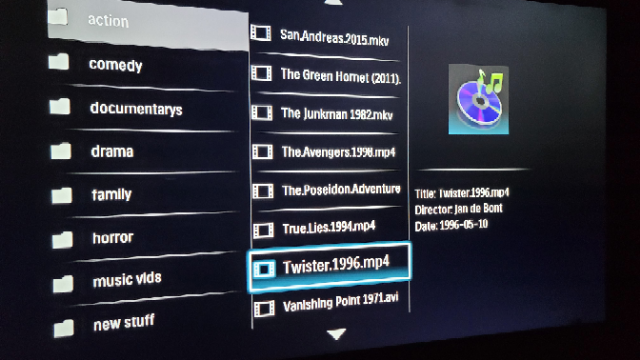

does anyone else own a phillips 49PFL4909/F7? I just got a second hand one for my granddaughters room and it sees serviio but every folder shows no playable files? in serviio console it says phillips 2010- will this tv play anything or is it too old. I have 2 Samsung tvs and roku boxes that work. maybe maybe the tv is just a dead white elephant

that's with direct tv selected as the profile

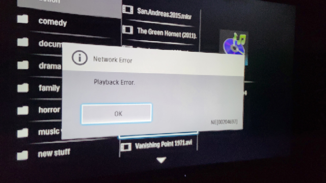

same thing, its like it doesn't even try to play the files instantly I get that network error ? on my Samsung I have had a few that it will try to play and I get not supported but that's not often . on this phillips its like it doesn't even try

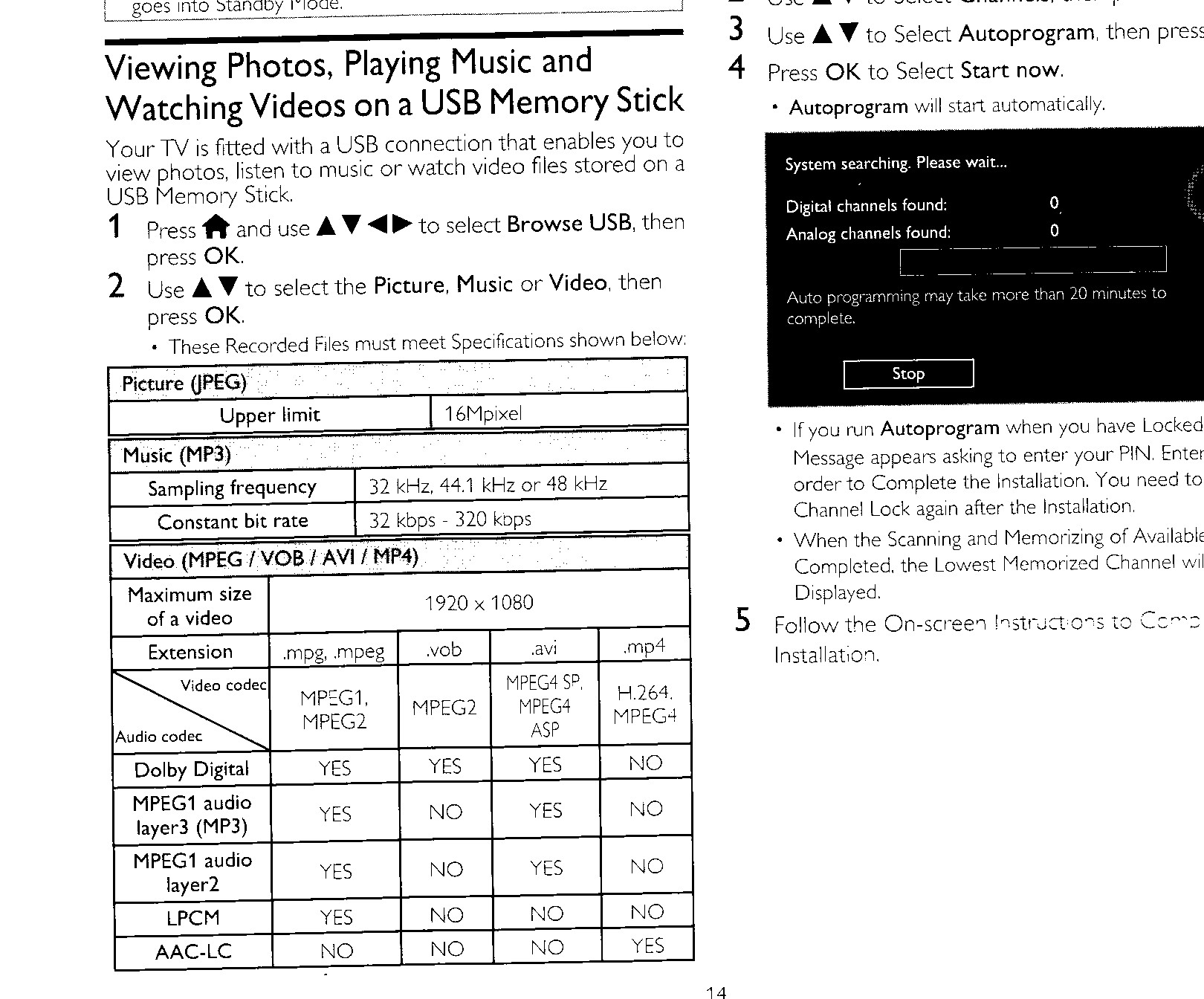

so i found the owners manual for the tv. see attached. stil dont understand why it wont play anything . doesnt serviio trancode if the file isnt compatable with the tv?
Posts: 5536
Post Mon Mar 08, 2021 2:28 pm
Re: 49PFL4909/F7 no playable files
Serviio will transcode, yes. But it requires an accurate profile to know what to transcode. For whatever reason, we can't seem to make one that works correctly.
That section of the manual refers to playback via USB. Many manufacturers have different media support between USB and DLNA. Doesn't make sense, but they do it. That's my guess with Philips.
