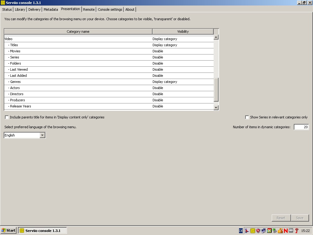

Just switched to serviio from tversity because of the much easier administration of content, how to sort it, add additional information with nfo-files etc.. Works like a charme.
There is one question though:
"Presentation" is selected like shown in the attached hardcopy.
Additional information is added with i.e. an "Avatar.nfo"-file like:

When selecting a video at the tv you switch down through the tree like:
- Video
- A
- Avatar
When looking at the display on the tv you have the tree on the left on the screen and on the right there is a movie-symbol above with the movie-name below and the word "unkown" just right under the name.
I did not have this "unkown" with tversity before. I do not have it with mp3s or photos. Just with videos. Since I did not have it with tversity it results from serviio, I guess. But I do not have a clue, what this "unkown" is trying to tell me, where it results from, whatever.
Does anybody here have an idea?
Sincerely
Karl
