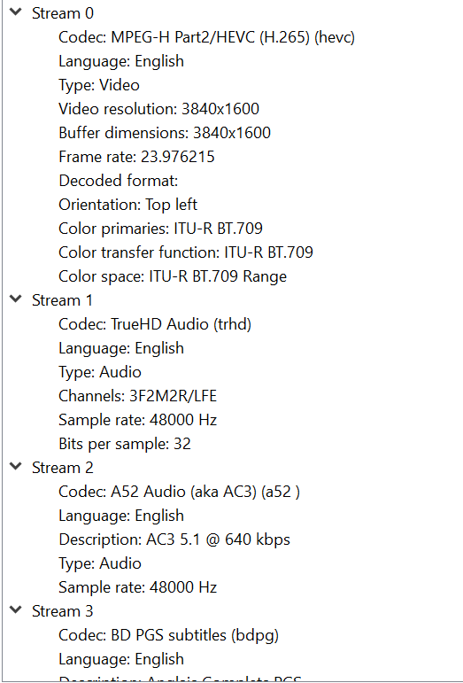

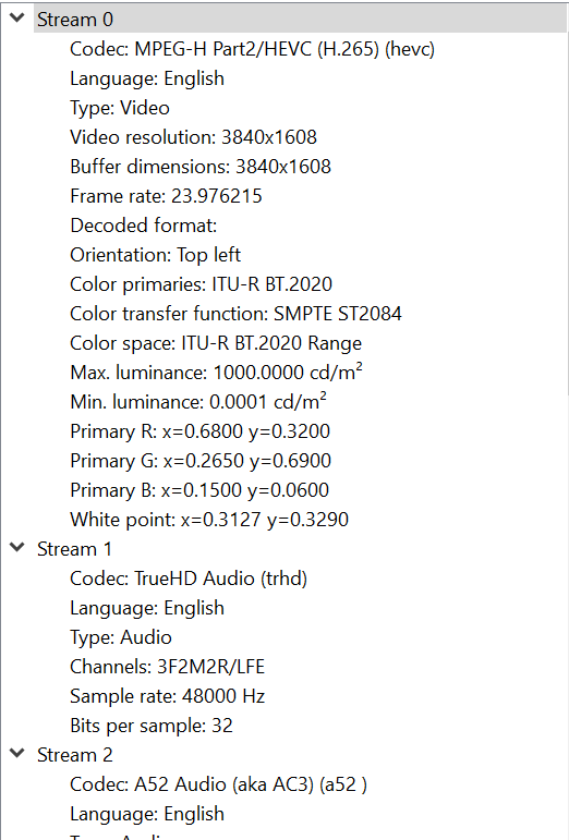

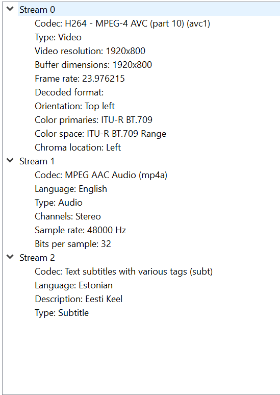

Here is files information....
Generetic profile not working with these videos. Server is Synology DS718+ serviio 1.9.2
HD videos from server works without problems in other Samsung tv. Only in current Philips TV i have a problems. Mostly tv says unable to open or find file when i click on some movie. It starts to load and then failure. But in server i see in that time that video are playing :roll:

HD Works only with Panasonic viera 2013 profile normaly.

4K wont run smoothly, hanging, buffering. Working only with Samsung J series profile.

4K wont run smoothly, also sound cutting. Works only with Samsung J series profile.

I see two of the three media files you posted the codecs for have Dolby TrueHD as the primary audio track. If the audio codec is unsupported, some players will play the video and not provide any audio, while others will fail to play them at all. I know of no TV that supports lossless audio, so that could be the cause of the playback failure. The Roku TV profiles (and I'm certain there are others) will play the video but transcode the audio to AC3 (Dolby Digital), which all TVs support.
Also, the first one (MPEG-4 part 10) might also be outside the supported codecs. The other two have HEVC (H.265) which they say is supported. But as DenyAll said the TV might not support the video bitrate. Note the specs that I quoted before: video bitrate can't exceed 20 Mbps, and the entire media bitrate (video and audio) can't exceed 30 Mbps. I exceed those bitrates with normal 1080p material, so any UHD material is most certainly going to exceed those bitrates. You may need to transcode them all with a bitrate limit added to the profile.
One test you can do is to use tsMuxeR (https://www.videohelp.com/software/tsMuxeR) and change the TrueHD audio to be the second audio track, and move the AC3 track to be first. That might make them playable. It doesn't alter anything else, so works quite fast.
HD (ace ventura.png) This one is works fine. Its a regular HD movie for me. Around 1.5gb file size.
4K (jon wick.png) This one dont run smoothly. Video buffering and hanging. Sound seems ok. Around 36gb file size.
4K (black panter.png) And this one have sound problem. Sometimes video playback hangs as well. Around 15gb file size.

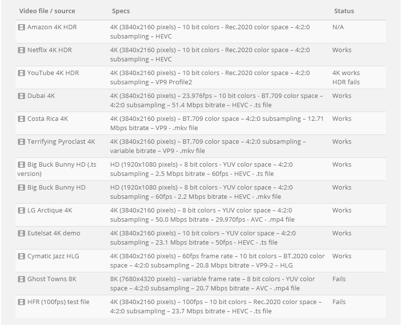

I found from internet a bit information. Maybe it is useful. See attached picture.
Source is https://www.flatpanelshd.com/review.php?subaction=showfull&id=1505461623
4K playback
