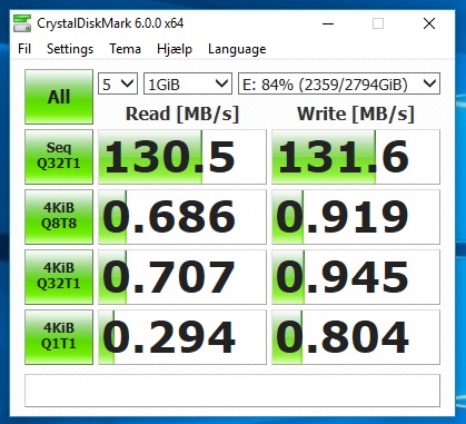

i have today check my harddrive. what do you say is my problem not there ?
and i have also make a write and read test " PLEASE SEE PICTURE"
it is only reading and writting with 130 mb/s

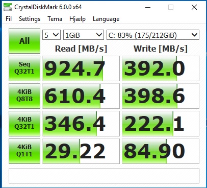

Now i have also copy the demo to the C where i have 2x SSD in Raid but i get the same symtoms.
and they have a read around 928 mb/s and write around 400mb/s, please see picture.

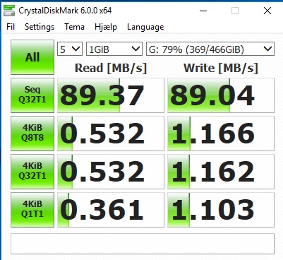

I have a Extern USB 3.0 harddrive and when i try to play over the televion with the USB menu, i get the same loading, but i am not sure if the
harddrive at to slow for HDR 4k.
USB Disk.jpg (69.95 KiB) Viewed 47475 times

I believe you might be misunderstanding those speed tests. Notice the speed is in MB, not Mb. The capitalization makes a difference. MB is megabyte, while Mb is megabit. Even your slowest hard drive (89 MB/s) is reporting over 700 Mb/s read speed, far faster than even the highest bitrate 4K video. So even streaming speed from the external drive is enough for 4K streaming, just not more than one at a time most likely.
