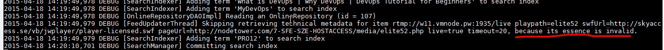

One question: have you tried to add manually the URLs ?
I have tried with a couple of them but I get the following error:
Possibly it requires a token, maybe it could be since the actual site requires a membership (login) so the stream blocks out any normal user from accessing the stream.

  built on Apr 13 2014 13:00:18 with gcc 4.4.6 (GCC) 20120305 (Red Hat 4.4.6-4)
  configuration: --prefix=/usr --libdir=/usr/lib64 --shlibdir=/usr/lib64 --mandir=/usr/share/man --enable-shared --enable-runtime-cpudetect --enable-gpl --enable-version3 --enable-postproc --enable-avfilter --enable-pthreads --enable-x11grab --enable-vdpau --disable-avisynth --enable-frei0r --enable-libopencv --enable-libdc1394 --enable-libgsm --enable-libmp3lame --enable-libnut --enable-libopencore-amrnb --enable-libopencore-amrwb --enable-libopenjpeg --enable-librtmp --enable-libspeex --enable-libtheora --enable-libvorbis --enable-libvpx --enable-libx264 --enable-libxavs --enable-libxvid --extra-cflags='-O2 -g -pipe -Wall -Wp,-D_FORTIFY_SOURCE=2 -fexceptions -fstack-protector --param=ssp-buffer-size=4 -m64 -mtune=generic -fPIC' --disable-stripping
  libavutil      52. 66.100 / 52. 66.100
  libavcodec     55. 52.102 / 55. 52.102
  libavformat    55. 33.100 / 55. 33.100
  libavdevice    55. 10.100 / 55. 10.100
  libavfilter     4.  2.100 /  4.  2.100
  libswscale      2.  5.102 /  2.  5.102
  libswresample   0. 18.100 /  0. 18.100
Parsing...
Parsed protocol: 0
Parsed host    : w10.vmnode.pw
Parsed app     : live
RTMP_Connect1, ... connected, handshaking
HandShake: Type Answer   : 03
HandShake: Server Uptime : 895927458
HandShake: FMS Version   : 5.0.1.1
HandShake: Handshaking finished....
RTMP_Connect1, handshaked
Invoking connect
HandleServerBW: server BW = 2500000
HandleClientBW: client BW = 2500000 2
HandleChangeChunkSize, received: chunk size change to 4096
RTMP_ClientPacket, received: invoke 126 bytes
(object begin)
Property: <Name:           no-name., STRING:   _error>
Property: <Name:           no-name., NUMBER:   1.00>
Property: NULL
Property: <Name:           no-name., OBJECT>
(object begin)
Property: <Name:              level, STRING:   error>
Property: <Name:               code, STRING:   NetConnection.Connect.Rejected>
Property: <Name:        description, STRING:   Connection failed.>
Property: <Name:        application, BOOLEAN:   FALSE>
(object end)
(object end)
HandleInvoke, server invoking <_error>
rtmp server sent error
RTMP_ClientPacket, received: invoke 18 bytes
(object begin)
Property: <Name:           no-name., STRING:   close>
Property: <Name:           no-name., NUMBER:   0.00>
Property: NULL
(object end)
HandleInvoke, server invoking <close>
rtmp server requested close
rtmp://w10.vmnode.pw:1935/live: Unknown error occurred
[root@nas serviio]#
A guess would be the fact that it is only parsing the first section of the stream not the playpath, swfurl or pageurl. Also no, you do not need a subscription to watch these streams, however just be aware that some of the streams do not play.
