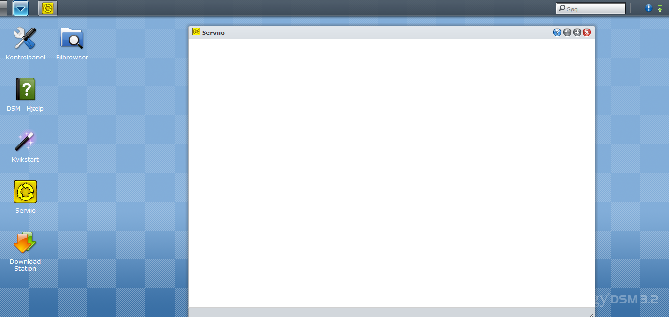

After I have upgraded the serviio web gui/ui to version 0.6b, I get this white screen after clicking the icon on my synology "desktop".
What is wrong?
patters
Posts: 1282
Post Sun Dec 04, 2011 10:22 pm
Re: Web UI in PHP
0.6b isn't the current version.
Make sure you have DSM 3.2 build 1955 or 1922 (1944 had problems apparently)
Open Package Center, in Settings add this repository http://pcloadletter.comlu.com and your NAS will automatically show the latest versions of the packages I made.
Also, try rebooting the NAS. It seems that sometimes during an upgrade, the old version doesn't quit properly.
