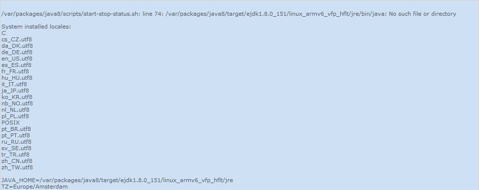

as i mentioned before, it'S the same problem as in this thread,
viewtopic.php?f=14&t=24139
looks like there's a problem with the Java installation
Java Logfile
Screenshot - 20171231.jpg (26.42 KiB) Viewed 15529 times
Any help hoe to solve this would be highly appreciated, the synology media server makes me bored bcs of it's slowly "conversion" which is only a thumbnail creation :x :roll:

It should work if you use the correct java file as posted by Langhuse above, because the DS218j and DS218play both have very a similar ARMv8 Realtek SoC. I fixed ARMv8 support for the Java package on 22nd Feb 2018, and Serviio on the 1st March which is a bit after your post here.
Notice these two CPUs share the same Package Arch descriptor which is what my package will use to determine how to install.
So my advice would be to remove any java install files you put in the 'public' share and try once more to install the Java 8 SE Embedded package. It will fail, but it will tell you specifically which java you need to download.
