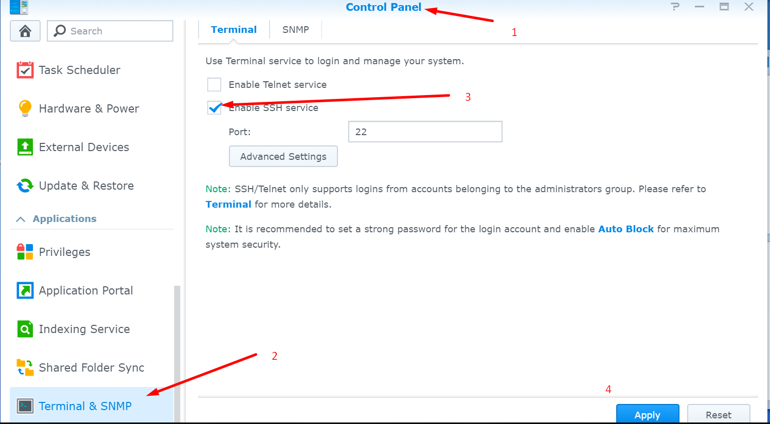

Hello mimis and sorry for late reply.
I tried to make a guide how you can see or find log files on NAS.
1. For first you need program called WinSCP https://winscp.net/eng/download.php And install it. (its a small client program)
2. Go to NAS and enable SSH service. (see pic 1)
3. Set up connection and connect. (see pic 2)
4. See log files. (see pic 3)
pic 1
pic 2
pic 3
