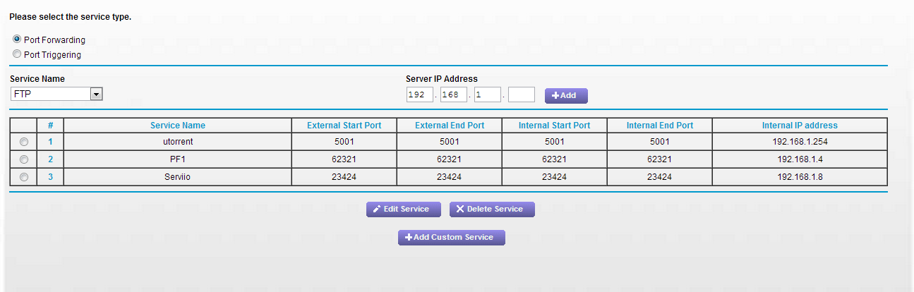

No Connectivity on VIERA TC-P55ST50
I installed Serviio yesterday and while it initially could connect between my laptop and my television, it hasn't been able to connect since. I believe I've forwarded the port correctly, and I've attached a screen shot of that page from my Netgear R6300 router. I've also attached the Serviio log.
I don't have this issue with other services i.e. PS3 Media Server or XBMC. It's just that I happen to like Serviio better, from what I've been able to see.
(153.41 KiB) Downloaded 1094 times
port forward.PNG (32.58 KiB) Viewed 26500 times

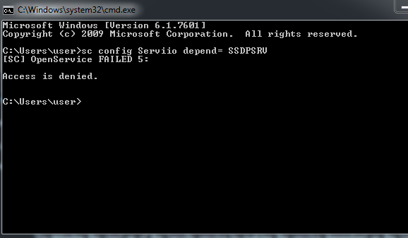

Post Fri Jun 21, 2013 2:22 am
Re: No Connectivity on VIERA TC-P55ST50
gmandel wrote:Done.
Is this now working (ie. you get the green tick)?
Still wrapping my head around what you are seeing. Does Serviio work fine some after starting your PC, but not other times... and if that is the case, if it is working, it remains working until after you restart the PC (and then it may or may not work)?
Try delaying the start up of the Serviio service by making the service dependant on the SSDP service. To do this, from an elevated command prompt type: sc config Serviio depend= SSDPSRV

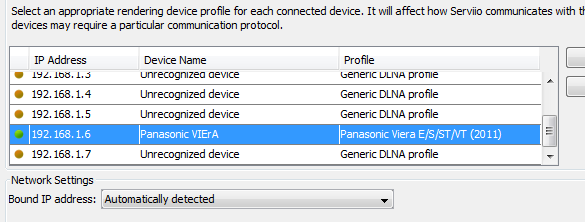

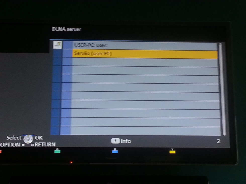

Post Sat Jun 22, 2013 2:09 pm
It's hit or miss at all times. But no connectivity in the past couple days.
I get an access denied message. See attached please. I've also attached a photo of my television screen, which has no icon beside Serviio. When Serviio isn't running, it says there are no DLNA connections on my tv, but when it is running and not connecting properly, this is how it looks.
Thanks again.
gmandel
Posts: 17
Joined: Sun Jun 16, 2013 12:37 pm
Post Sat Jun 22, 2013 2:12 pm
> One other thing to check, although I doubt it would cause a problem on your internal network. Is your Serviio computer using a static IP address, or is it being assigned during bootup? Sometimes a changing IP address can cause issues.
There appears to be a list of IP addresses, with 192.168.1.6 being the correct one. More often than not, it has a green dot, but sometimes it goes red... Please see attached. And although I saved the Bound IP Address as Automatic, it reverts back to 192.168.1.101. Not sure if this is what you're talking about? Thanks.
Post Thu Jun 27, 2013 12:37 am
Sorry, just getting back to this. The error you get when trying sc config Serviio depend= SSDPSRV suggests you didn't run it as an elevated command prompt. You need to type cmd in the start menu and then right click on the cmd.exe that appears. Select Run as Administrator. You should be fine then to run the command.

Post Thu Jul 04, 2013 8:53 pm
And my apologies for taking a week to respond, but my laptop was being repaired. Tried that command as Administrator and it was successful. Having said that, Serviio is back up and running smoothly right now... Thanks very much for all your help. I'll check back in if it stops. Regards.

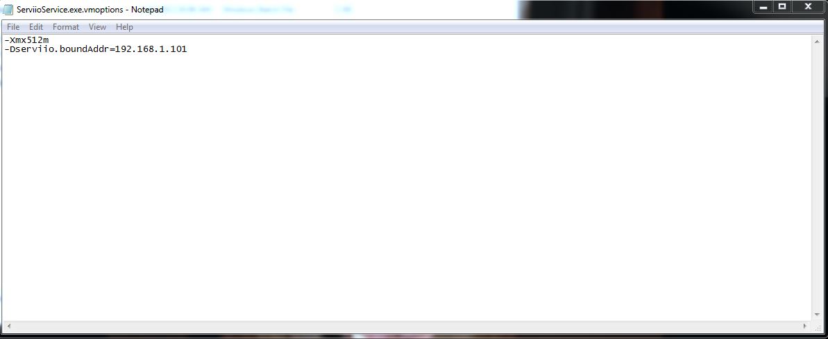

Post Mon Jul 08, 2013 2:45 pm
So, I can see what the problem is (if not the why). Serviio is binding to the loopback address 127.0.0.1, rather than the IP address of your server.
Can you try forcing Serviio to bind to your IP address by:
  • In Serviio console, setting the Bound IP address to your servers IP (192.168.1.101 ?). Remember to press save.
  • If this doesn't work, try adding the following to the ServiioService.exe.vmoptions file (located in the serviio\bin folder. Edit with any text editor)
      -Dserviio.boundAddr=192.168.1.101
    Restart your PC (or the Serviio service using services.msc if you know how to do that) after making the changes.

Post Thu Jul 11, 2013 2:01 am
Hmmmmm... thanks for sharing your experiene TheXman. Turns out it was the sound bar the blew and not the television, so I can indeed play around with this again.
I don't seem to be able to do this. Under Bound IP Address, I have a dropdown with two options - Automatically detected and 192.168.1.6. Is there another area besides the bottom of the Status Tab where I can alter this setting?
I tried this (see attached) and restarted my computer, but no connection on the tv.
Sorry, this must be a real pain. Thanks for the help.
From the earlier screenshot it appear that your Panasonic TV is using the 192.168.1.6 IP address. And in the later post your Serviio computer is using the same IP address (which you get in the bound to adapter drop down list).
I suggest you turn off both devices first, start one first, wait five minutes and then start the other one. If you are not using static IP on both the TV and the computer then you will get no conflicts.
Post Thu Jul 11, 2013 7:52 am
... and looking at the OP it looks like Serviio had the 192.168.1.8 address.
Although not a requirement for Serviio, I'd recommend setting reserved IP addresses for your Serviio server, at the very minimum, and also for each TV/renderer. In your router you can reserve addresses under Advanced, Setup, LAN Setup.
