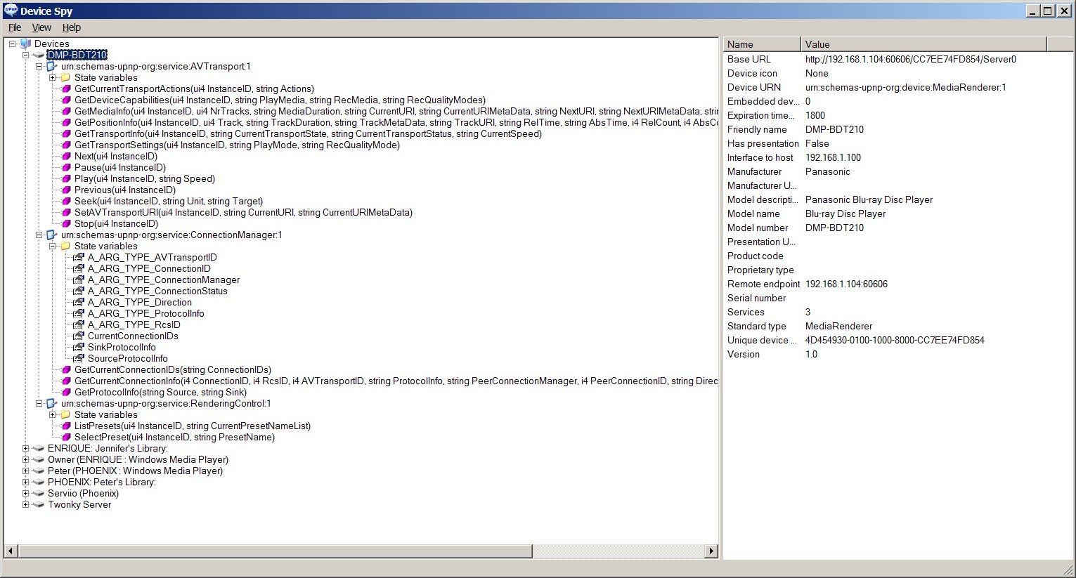

EDIT: can you also see if device is detected by device spy http://wiki.serviio.org/doku.php?id=device_sf
PMI
Posts: 156
Joined: Tue Jan 03, 2012 3:32 am
Location: Milwaukee, Wisconsin
Post Tue Jan 03, 2012 7:47 pm
Re: Panasonic BDT210
Cerberus wrote:EDIT: can you also see if device is detected by device spy http://wiki.serviio.org/doku.php?id=device_sf
I'll take this first, b/c simpler: Not sure what this does, but I did try this earlier...
Edit (sorry, my bad, too much multi-tasking in the organic CPU):
The player shows up in Device Spy along with a list of about six other upnp devices, with its default name (I think default auto registration is turned on in the player settings right now).

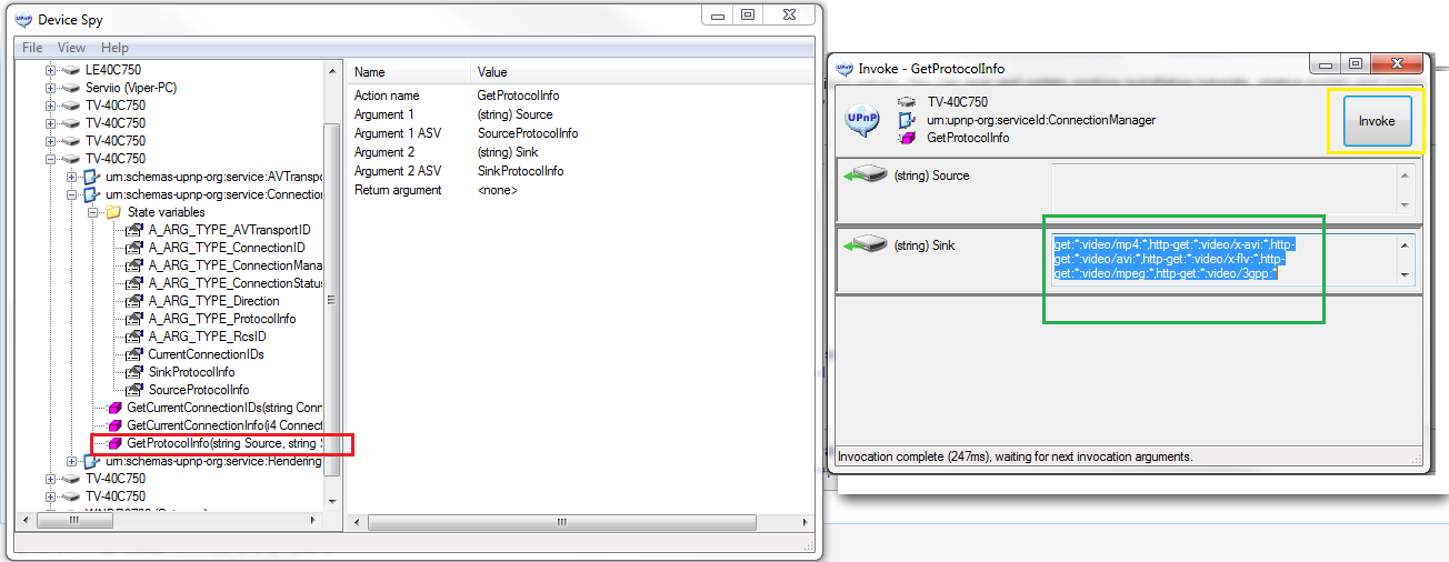

can you post the protocol information please as player does show up then a proper profile can be made for the Panasonic BDP
PMI
Posts: 156
Post Tue Jan 03, 2012 9:58 pm
Cerberus wrote:can you post the protocol information please as player does show up then a proper profile can be made for the Panasonic BDP
Sure, but where to start?? I am new to this forum, new to Serviio (only started digging in this past weekend, until then it seemed pretty much it just installed and worked), never used Device Spy until I followed a link from here (and I still don't know why my firewall is throwing exceptions when I run it), and there are pages of stuff when you drill down from the device name.... (!)
Peter
Panasonic Viera TC-L32E3 LCD | Panasonic DMP-BDT210 | Windows 7 |
Post Tue Jan 03, 2012 10:16 pm
no problem i dont mind talking you through it. :)
1. Expand the device's tree and find service: urn:upnp-org:serviceId:ConnectionManager:1
2. Expand that and double click on GetProtocolInfo(…). (Red Box)
3. Click on Invoke. (Yellow Box)
4. Copy information to motepad and save as txt file. (Green Box)
5. Attach the txt file here so that it can be looked at by the mods/admin here and a profile made up.
