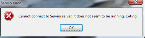

<Video targetContainer="mpegts" targetVCodec="mpeg2video">
<Matches container="mpegvideo" vCodec="mp2" />
when I insert above as described the console refuses to start and exits with message that server is not running

Post Thu May 19, 2011 6:08 pm
Re: Q about supported file types
it does not change anything.
restarting of console is not possible, not even after starting server again.
AFter ending like subscribed i have to stop server, start server, start console then I get the error message that server is not running : see attached

Post Thu May 19, 2011 6:27 pm
There is a mistake in your profile file.
2011-05-19 20:03:21,411 ERROR [XmlUtils] XML Profiles.xsd didn't pass validation, reason: cvc-enumeration-valid: Value 'mp2' is not facet-valid with respect to enumeration '[vc1, mpeg4, msmpeg4, mpeg2video, mpeg1video, h264, wmv2, mjpeg, flv, vp6]'. It must be a value from the enumeration.
2011-05-19 20:03:21,411 ERROR [MediaServer] An unexpected error occured. Ending the application. Message: org.serviio.profile.ProfilesDefinitionException: Profiles XML file is not valid (according to the schema). Check the log.
Try replacing the "mp2" with "mpeg2video"
