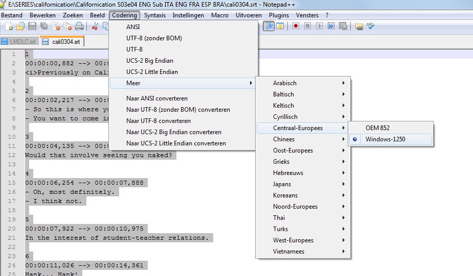

...can you maybe explain me how to check this on a srt? I could not find a decent way to check this out.
http://en.wikipedia.org/wiki/Character_encoding
With txt editor tool like Notepad++
cvdmolen
Joined: Sun Jul 24, 2011 4:04 pm
Post Mon Jul 25, 2011 8:18 pm
Re: LG BD660 -> Can't get the SRT working
So your SRT file is corrupted ? or corrected srt file doesn't work too?
Nope I just liked the simple non interface of the program, SRT was not corrected or corrupted in any way.....
Tnx, I did check it with Notepad++++ and convert it to:
ansi 1250
But still not working.... H E L P : )
