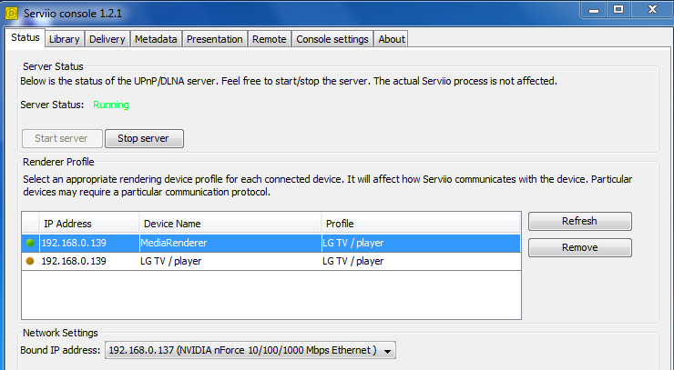

Something isnt adding up here...
* With transcoding checked & <Matches container="mp4" /> inserted into the profiles.xml file the file shows on the TV but is greyed out and unplayable. As soon as i uncheck transcoding and restart the PC & TV the file is all of a sudden playable (although not watchable).
*The TV is showing two IP/entries on Serviio for the same device (see pic).
Its almost as if the TV doesn't want to transcode and forcing it just makes it not play at all ?
Ideas ? ?
Pete

Post Sun Jun 09, 2013 4:48 am
Re: LG 47" MP4/1080 Files Stutter ?
Interestingly at some stage it discovered the TV with a different Device Name.
Remove both devices, press save then do a refresh - it should only pick up one TV. Select the LG profile and press save. That should fix the issue of the two devices.
Am at a loss as to where to go with transcoding without having that TV and file in front of me. Try removing (commenting out) the <MediaFormatProfile mime-type="video/mp4" name="">AVI</MediaFormatProfile> line and see if that helps - with transcoding on and of). Also post a detailed log while playing, or attempting to play, the file.
How many files fail - if its only one or two it may be easier just to permanently transcode them.
