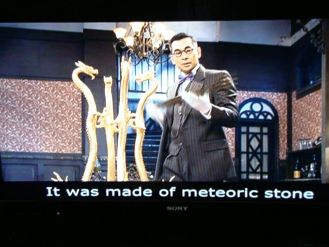

lelin
Joined: Mon Oct 29, 2012 3:47 pm
Post Tue Oct 30, 2012 10:32 am
Re: Subtitles, why it works on PS3MediaServer & not on Servi

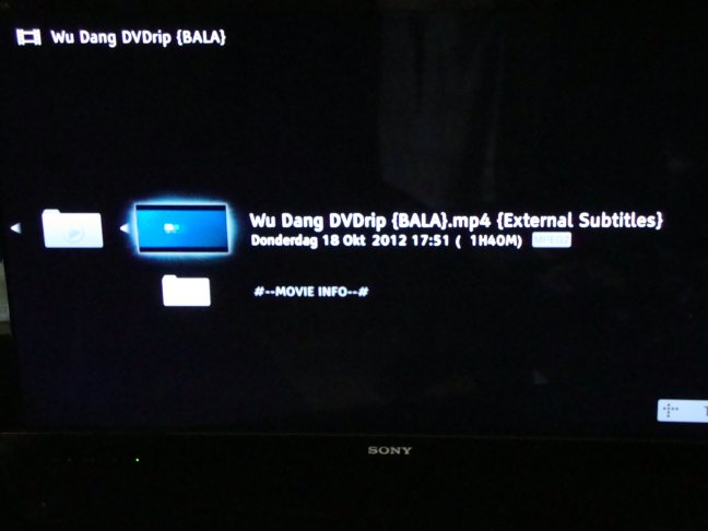

In attachment the log and pictures
Hope this helps

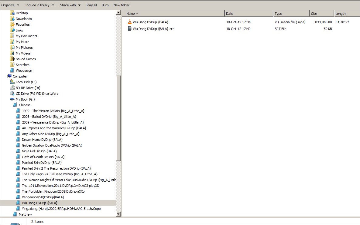

lelin
Post Tue Oct 30, 2012 10:34 am
Herewith my movie filing
Post Tue Oct 30, 2012 10:42 am
On your photo above, what does it say in the white rectangle next to the (1H 40M)? Mpeg2 or AVC or MPEG4?
