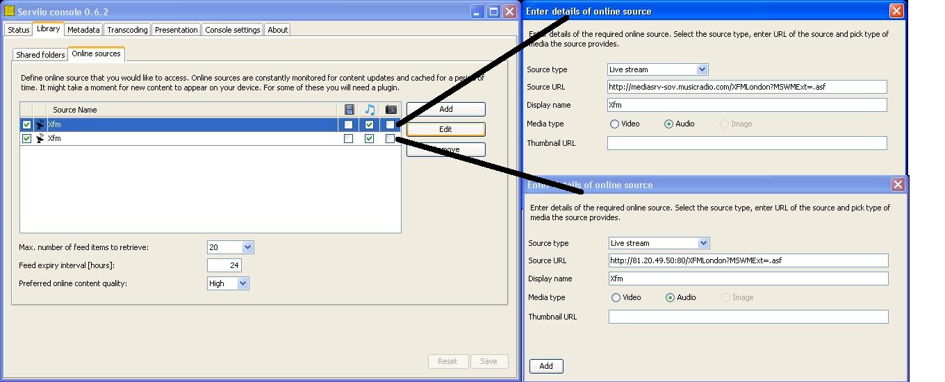

Hi all,
first post and pretty new to the "advance features" of Serviio, so bare with me while I pick it up :)
I have successfully set-up Serviio to transcode and stream music, and videos to my Sony Bravia KDL-32EX403.
But I would like to stream XFM (UK Radio Station) as it currently does not transmit on the Freeview built in to my TV.
I attempted to set it up, but am unable to find it on my TV under "Music>Serviio>Online" (Am I even looking in the right place?)
Here is a screenshot of the Serviio (excuse the poor paint skills lol)
Theses are the lines I added
http://mediasrv-sov.musicradio.com/XFML ... WMExt=.asf
http://81.20.49.50:80/XFMLondon?MSWMExt=.asf
Am I doing something wrong?

those URLs point to a playlist file, but that playlist doesn't include any real links to the stream, only links to itself. Something's fishy there - basically you have to put the content URLs in Serviio console, not a link leading to a playlist (a text file basically).

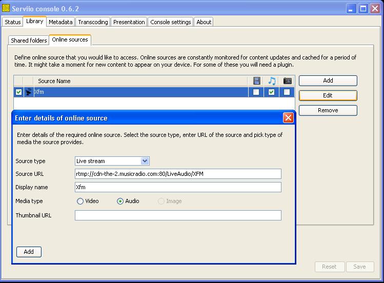

See screenshot below
This is the line I entered
rtmp://cdn-the-2.musicradio.com:80/LiveAudio/XFM
not sure how Cerberus got this link, but it works
also, I found it on my TV under
HOME > MUSIC > SERVIIO> ONLINE
hope this helps

took a page out of illico's book and did a url snoop to get the actualy content url form the link you posted :)
