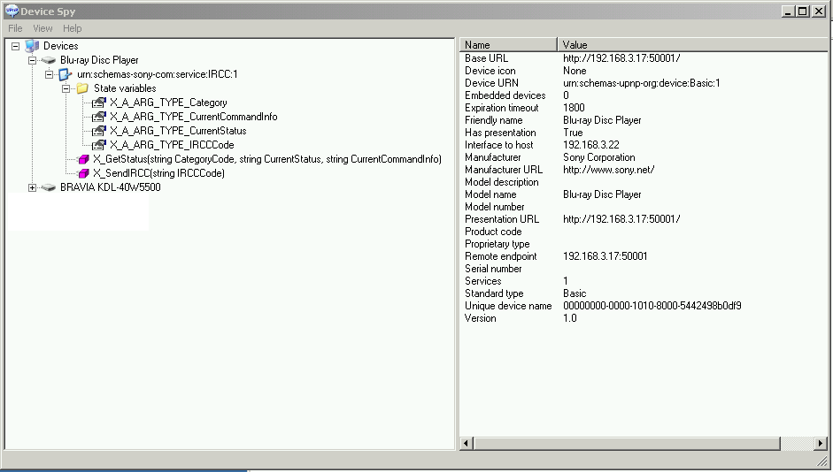

You are right here. The BDPs don't advertise themselves on the network as DLNA renderers (you can confirm by it not appearing in DeviceSpy), therefore the DMC cannot see it. Serviio has a workaround based on the fact the player can see Serviio and eventually will connect to it - that's when Serviio gains knowledge about the player being on the network.
Nothing Serviio can do for you in this case. Not sure if there is a DMC that can do it, maybe one that'd enable you to enter the player's IP address (similar to AVMediaController's Add device functionality)

I did attach a Device Spy screen copy: there is no ConnectionManager service as in other renderer (Bravia TV): only service seems to be IRCC...
I'm afraid outlook is not looking good...
