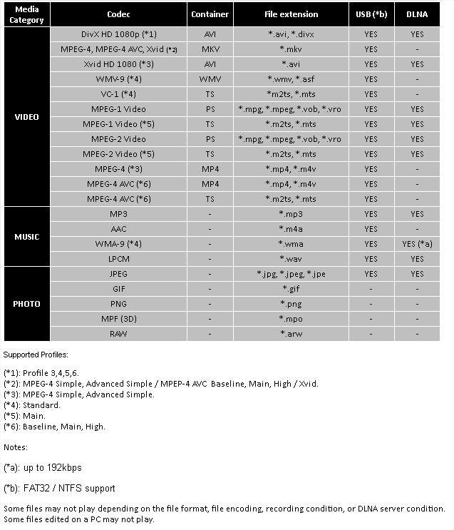

Because its seems that SMP-N100 (EU model) is very similar to BDP bluray player and Divx are supported. I think we could use "Sony BD Player profile" (to be confirmed).
- root categories folders also disappears with BD profile selected.
EDIT: look at this link : http://support.sony-europe.com/tvhc/faq ... 0&f=HV_SMP
The latest question [21] is : Which codecs are compatible with my device?
patters
Posts: 1282
Post Sat Oct 22, 2011 11:29 am
Re: Sony SMP-N100 Media Player
I can confirm that the Euro model of the SMP-N100 seems to be fine on the Sony BD Player profile with MKVs and AVI (the most contentious formats). I think the only thing that wasn't working for US owners was AVI (which gets presented as MPEG mime type). Can someone confirm this? And can a US BD Player owner check whether AVIs are working with the BD profile as it is?
