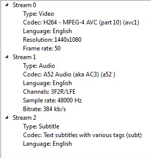

I would like some insight in fixing this issue. I am currently trying to play a .mkv file with codec information in the attached image on my Sony Bravia KDL-40EX700. I am getting the message "Temporarily cannot access the server. Please retry."
Other .mkv files work flawlessly with my configuration but I believe this one has a different audio codec then the others.
I have the latest Serviio (0.6) installed on my PC.
Short of recoding the file, is there something I can add to the Bravia profile to enable this one to play?
MKV file codec information
Post Sun Sep 25, 2011 6:20 pm
Re: transcoding issues with bravia
nope file would have to be reencoded i ahve never heard of AC3 being referred to as A52 before.

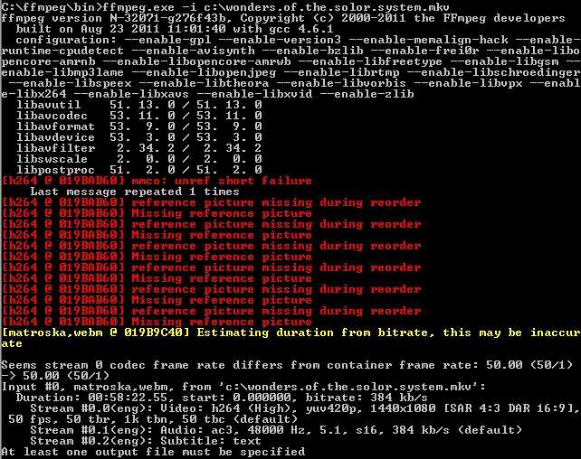

I hope this helps Petr. It doesn't make a whole lot of sense to me so if you could explain what you find a bit I would appreciate it.
FFMPEG file info
Post Mon Sep 26, 2011 8:45 pm
damn thats one broken file

Post Tue Sep 27, 2011 8:42 pm
Thank you for the information. It was nice to see the process at which everyone took to determine the issue.
I obviously knew there was something wrong but considering VLC player plays the file I wouldn't have thought it was corrupted.
So I suppose the only question I have left is that if FFMPEG has an issue with transcoding the file wouldn't I have an issue recoding?
Post Wed Sep 28, 2011 7:35 am
VLC is very permissive, it "ingests" has just about everything!!! ffmpeg is just after...
