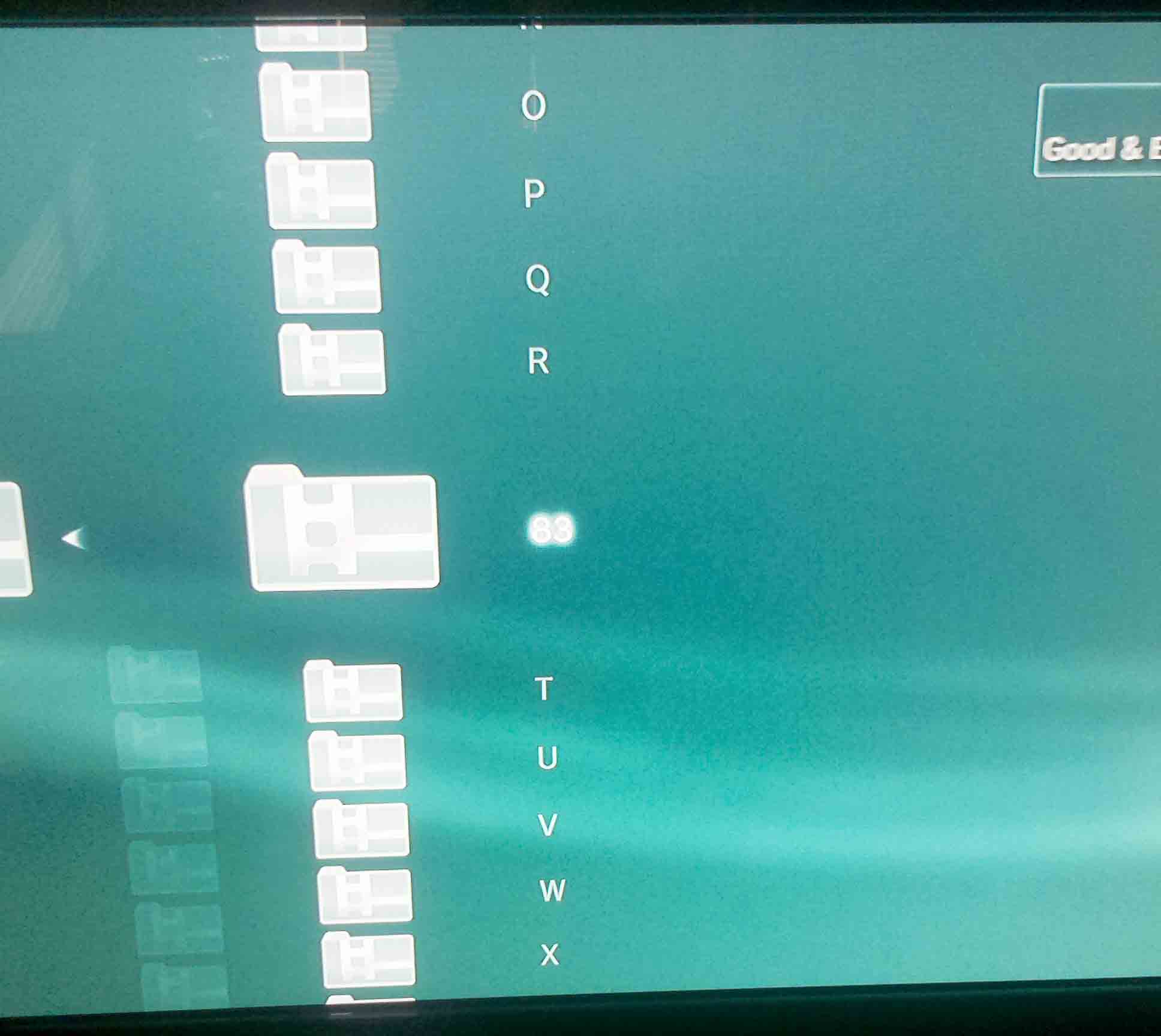

Here are shots of the PS3 screen.
Step 1. I already went into the "S" folder and now the label shows "83". Note that the "U" folders label is properly rendered.

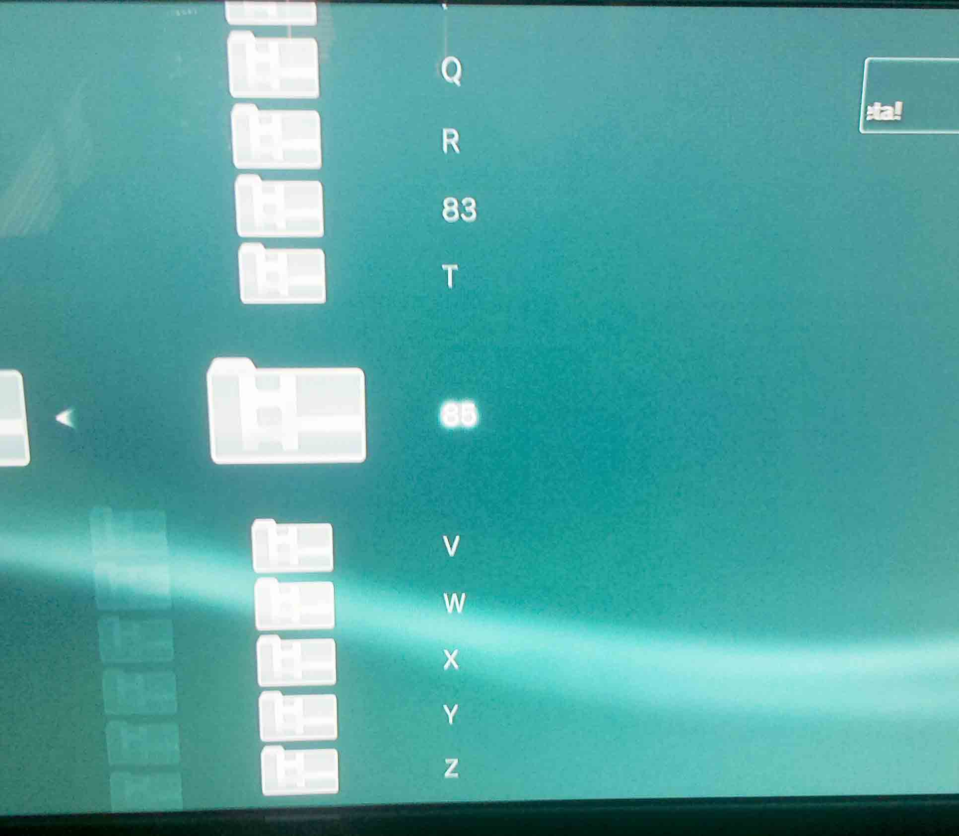

Step 2. I enter the folder labeled as "U" to browse.
Step 3. When I exit the "U" labeled folder, it now displays as "85"
step 3.jpg (77.04 KiB) Viewed 17823 times
step 1.jpg (79.97 KiB) Viewed 17823 times
