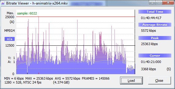

Re: Sony S570 stuttering - how do I change the socket buffer
Could you check the average and peak video bitrate of your file with that tool : viewtopic.php?f=17&t=2133 ?
Illico wrote:Could you check the average and peak video bitrate of your file with that tool : viewtopic.php?f=17&t=2133 ?
The average bitarate on this file is 5572 kbps and the highest peak 25363 kbps.
This file played nicely today, even over wifi !
I'm wondering if the fact I had a download running on the disk when I tried it yesterday wasn't responsible for the stuttering.
Or maybe some other processes were slowing it down...
Anyway, I'm very happy to be able to play 1080p over wifi now
Dejavu wrote:This file played nicely today, even over wifi !
Good, but I think you'll have stuttering with such movie, 25Mbps its a very high bitrate for Wifi
