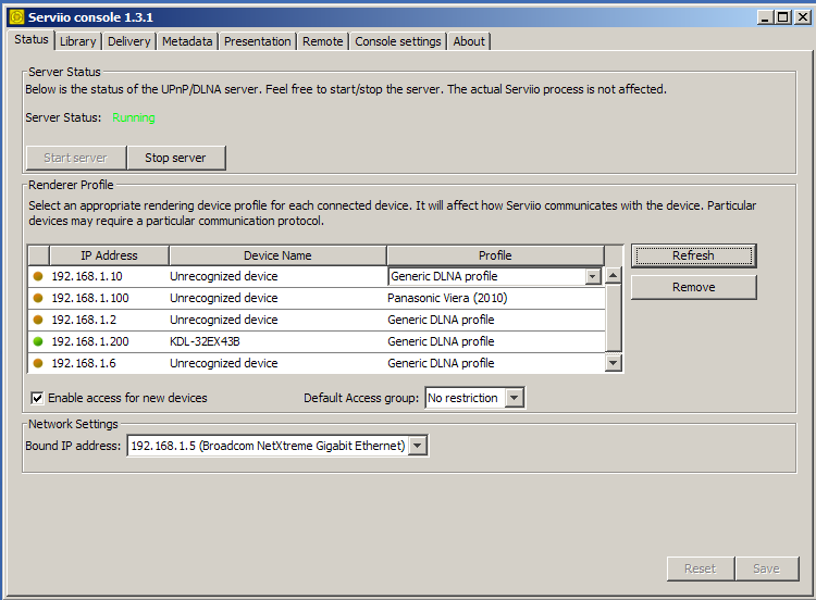

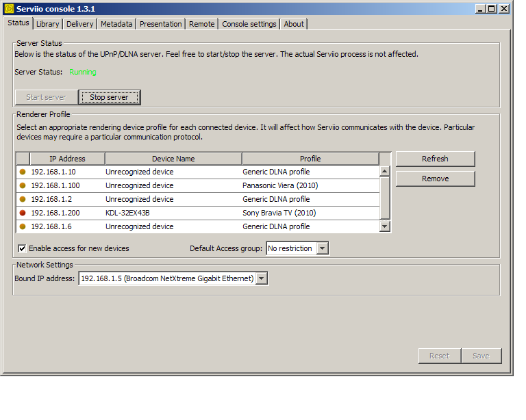

1. Serviio setup to work with Bravia KDL-32EX43B (using fixed IP 192.168.1.200) using the Sony(2010) profile. Serviio runs on IP 192.168.1.5. Image 1 which shows the Serviio before I turn on the TV as indicated by the red dot icon.
2. I turn on the TV and start streaming the video with no issues. I stop the video and come back to the menu and the TV can no longer read the directory listing from the server. The server now shows a green dot icon, however, the profile has changed to the generic DLNA profile.
