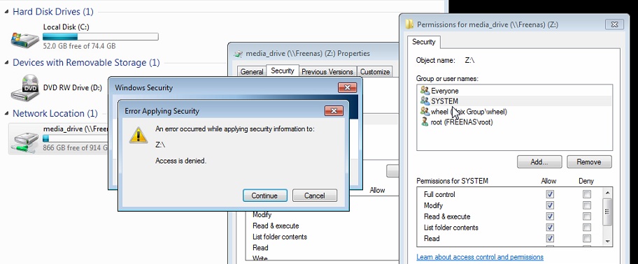

That may be the issue I am having. That post was very helpful, but I can't add permissions.
I am logged in as the admin, and the everyone profile is there, but no SYSTEM. When I try to edit permissions, I get an access denied error...
I've tried editing the permissions on the mapped network drive as well as the individual folders that reside within.

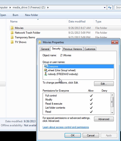

Post Thu Sep 26, 2013 5:33 pm
Re: Sony HBD-T79 no content available on network drives
Oddly enough, the sub folders seem to have the permissions (not SYSTEM) that the main mapped drive says it does not.
When I edit the permissions of the folders, they have all or most of the boxes unchecked. But this screenshot shows that they appear to have proper permissions.
Post Thu Sep 26, 2013 10:53 pm
Hmm - the Everyone user normally does it as it allows access to ... well everyone. I wonder if the security tokens aren't propagating properly - they should be inherited down to all subfolders and files.
